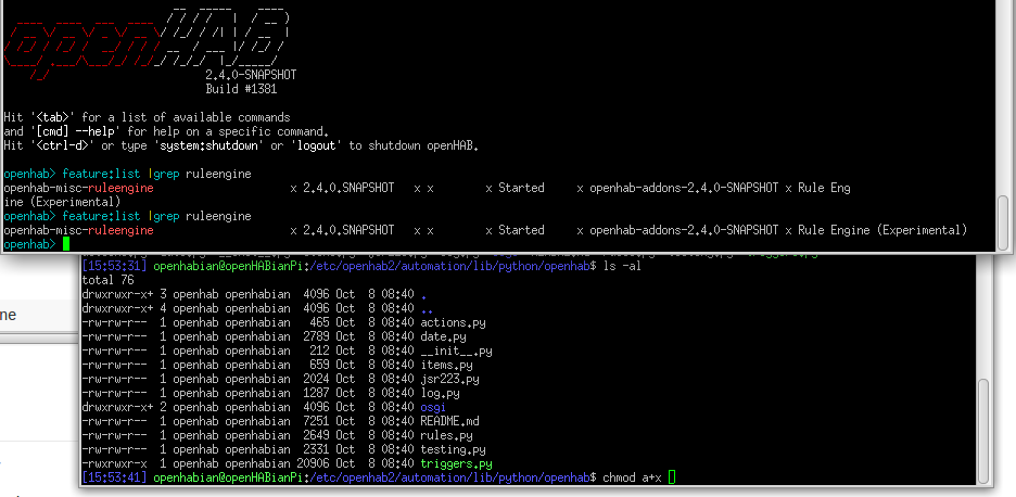

Does the openhab dir and feature list look ok? Wandering why triggering.py has different permissions.
Lookin’ good!
That shouldn’t affect anything, but it’s weird. I see the same on a fresh download.

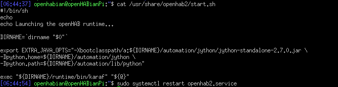

And please post your start.sh too…
#!/bin/sh
echo
echo Launching the openHAB runtime...
DIRNAME=`dirname "$0"`
export EXTRA_JAVA_OPTS="-Xbootclasspath/a:${DIRNAME}/conf/automation/jython/jython-standalone-2.7.0.jar \
-Dpython.home=${DIRNAME}/conf/automation/jython \
-Dpython.path=${DIRNAME}/conf/automation/lib/python"
exec "${DIRNAME}/runtime/bin/karaf" "${@}"

start.sh looks like this:
I changed the components directory name to 100_components and added the 000_startup.py script to /automation/jsr223/ then restarted and tested again.

The hello world and the time out script worked but nothing from:
from org.slf4j import Logger, LoggerFactory
log = LoggerFactory.getLogger("org.eclipse.smarthome.model.script.Rules")
import sys
log.debug("JSR223: version=[{}]".format(sys.version))
log.debug("JSR223: path=[{}]".format(sys.path))

I noticed in post #17 inside python you have openhab only and I have esper and openhab. Not sure what that means but moving it to a temp dir didn’t seem to change anything.
Here’s what it looks like now, notice the openhab2-conf (this may be due to samba share)
I’ve also tried changing permission in automation/lib/python/openhab for all files so they matched triggering.py (chmod a+x on all) No change.
