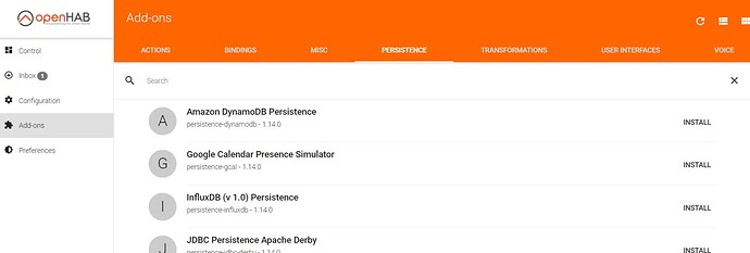

Installing rd4j via PaperUI shouldbe straigth forward.
On PaperUI select Add-ons on the side menu, then Persistence on the on thetop menu, thatwillpresent youtheinstallable services. Move to rrd4j andclick the"Install".
Since you have already the rrd4j.persist file theservice should start immidiatly.
Give it some time and then you can use the REST API to fetch the stored data.

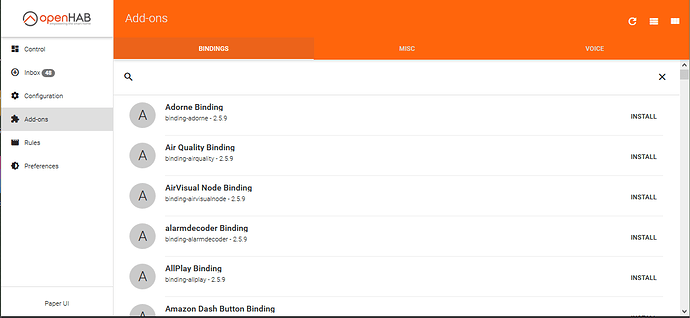

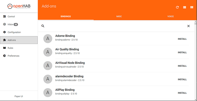

Your description is the way that I would expect … but … on the Add-ons-Side there are only “Bindings”, “Misc” and “Voice” but inside of all tree menu topics ther is no persistence option/selection available. Do I have to unlock this somewhere?
Can’t really say. I’m on 2.5.9.1 Release Build.
If you are on the same version, I’d restart, check the logs and if that doesn’t give a clue I’d restart from scratch.

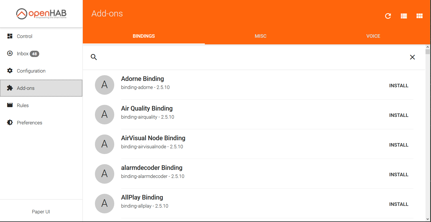

I updated to veriosn 2.5.10-1 … but … nothing changed …
Is there a way to hide some Add-ons or to I have to unlock them in the system-seetings?
