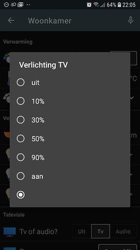

Hi all,
I am using Groups to set the brightness of groups of Hue lights. I frequently use the android app on a small screen and the slider is difficult for my large fingers ;-). So I like to use ‘Selection’ and map a few discrete values to the group. This is working nicely. But I don’t understand why the value that is set to the group, is not displayed on the sitemap like with other (string) selections I have?
For instance: I set ‘TV-lights’ to 30%, and I can see in the log this is what the three lights above the TV are set to. But after setting the lights, the group will display just the drop down arrow, and when opening the drop-down, it wil show a bullet underneath all others, without text.
items
Group:Dimmer:AVG gVerlichting_TV "Verlichting TV" <light>
Dimmer TV_1 "TV 1" <light> (gVerlichting_TV) {channel="hue:0100:00178:14:brightness"}
Dimmer TV_2 "TV 2" <light> (gVerlichting_TV) {channel="hue:0100:0017:15:brightness"}
Dimmer TV_3 "TV 3" <light> (gVerlichting_TV) {channel="hue:0100:0017:16:brightness"}
sitemap:
Selection item=gVerlichting_TV mappings=[0="uit", 10="10%", 30="30%", 50="50%", 90="90%", 100="aan"]
How can I get the current setting on the drop down on the sitemap?
