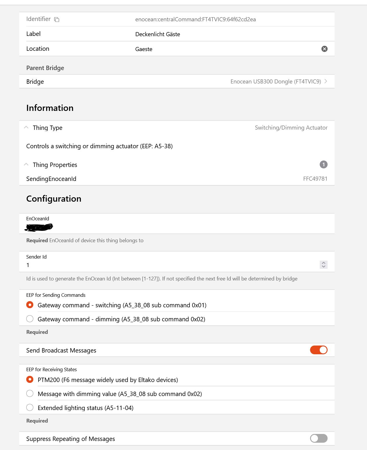

I found that if I add a new Enocean device in “things”, I can run a scan. But this yields nothing, even if the actuators are in learning mode during the scan. I also tried to manually create a thing with type EnoceanBinding → Switching/Dimming Actuator and entered the Enocean ID that my actuator has (see attached image). It shows “online” after a while, but nothing happens when I switch the control.

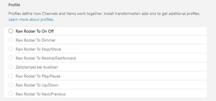

Thank you for the help. The rocker switches are easy to recognize in openHAB. Once in scanning mode, they are reliably detected as a thing. I did then follow the procedure to create a switch item of the A and B channels (there is no teach-in channel), just Channel A, Channel B and Switch Action. I created a switch item out of Channel A and use the profile “Raw Rocker To On Off”, for the lack of a better option.
I guess this was wrong, as teach-in does not work when I set the actuator to teach-in and then operate the switch item in openHAB.
Any more ideas? Below a few screenshots.
This is the selection of profiles in the Channel A or B of the rocker

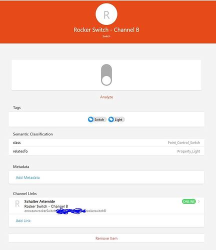

And this is how the switch item looks like when finished. But does not work for teach-in

Try to create a switching/dimming actuator like you did at your first picture.
Then go to the channels section of this actuator.
Look for the teach in channel and link a (new and unused) switch item to it.
Set your physical actuator into learning mode and trigger the switch in openhab.
