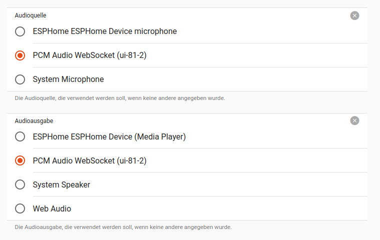

under them menu point “Audio” I choosed my web audio devices

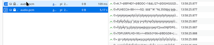

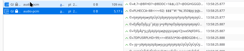

Voice: Starting microphone audio streaming index-BJBtX3R_.js:15742:72
in this moment I can see in the browser network tab that a lot of traffic is sendet to openhab.
But nothing happens. I don’t see any logs on server side. Not for voice, not for rustpotter and not for vosk. Looks like he is sending audio stream forever.
