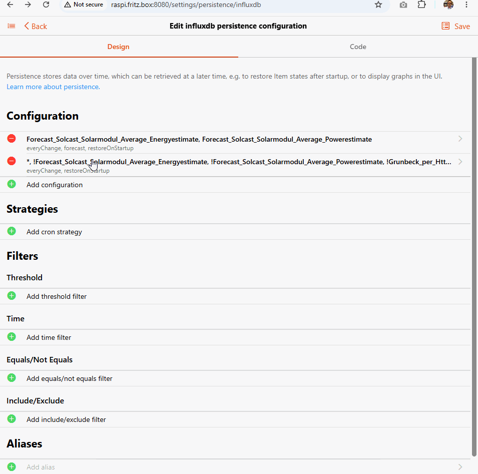

I have the influxdb and use the MainUI.
When i setup the config i did it like shown below.
Question 1:
Is tit plausible (logical) like i configured it with 2 section in configuration?
Question 2:
In that case I phase an issue when I edit one of the “Configuration” then both will be overwritten with the same settings. (I createda n animated gif)

This is what happens.
Persistence
It looks reasonable to me.
That looks like a bug. Please file an issue on openhab-webui.

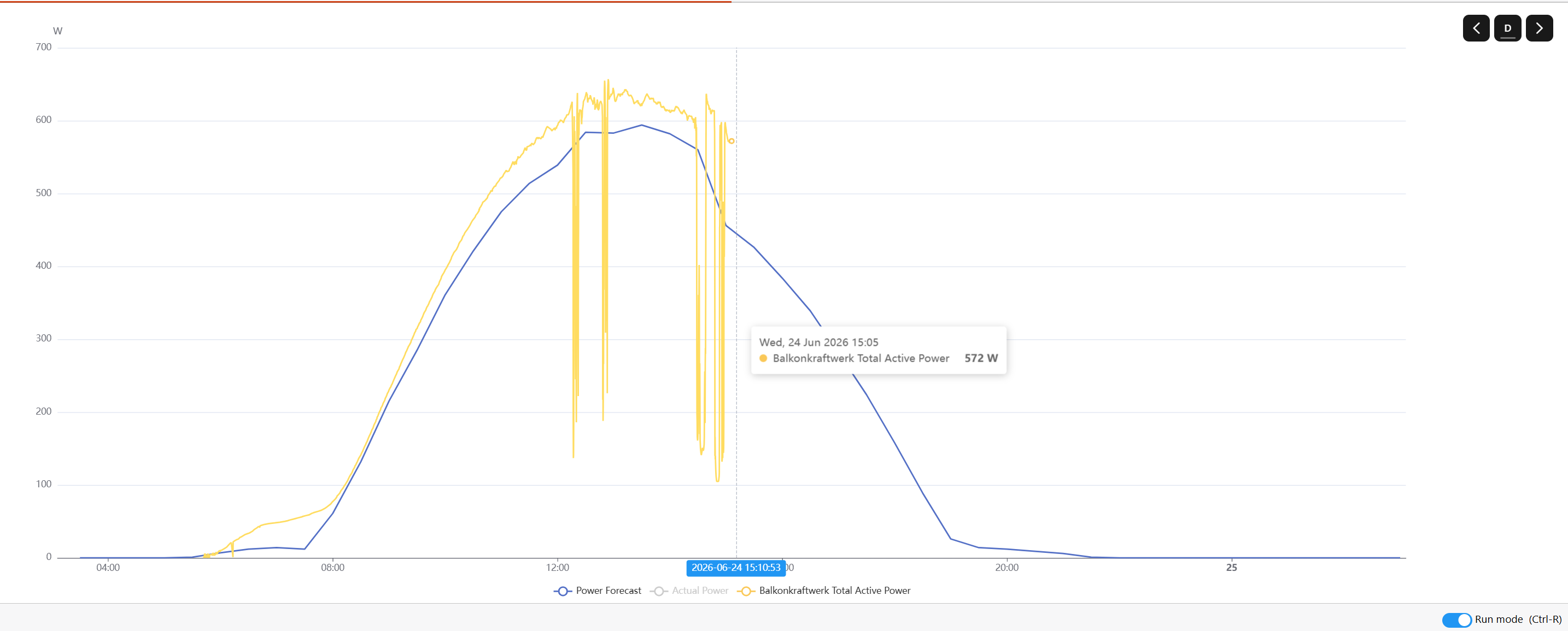

If i want to keep the forecast information for comparison like in this solar plugin i can adjust a factor of eficieny like 90%.
Is here a way to keep the “real” forecast in memory but store the “archived” one?
If i click on he forecast at the moment i see:
The time point shows my “now”.
Means i can also see “old” archived foracasted measurements.

As the forecast becomes “now”, persistence updates the Item automatically. So you can include the Item in your InfluxDB persistence, just don’t use the forecast strategy there, just use every update or everyChange. For in memory, only use forecast.
Then as the forecast becomes the “now cast”, the item is updated and saved. InfluxDB. will shower the past values but it won’t show the future values.
