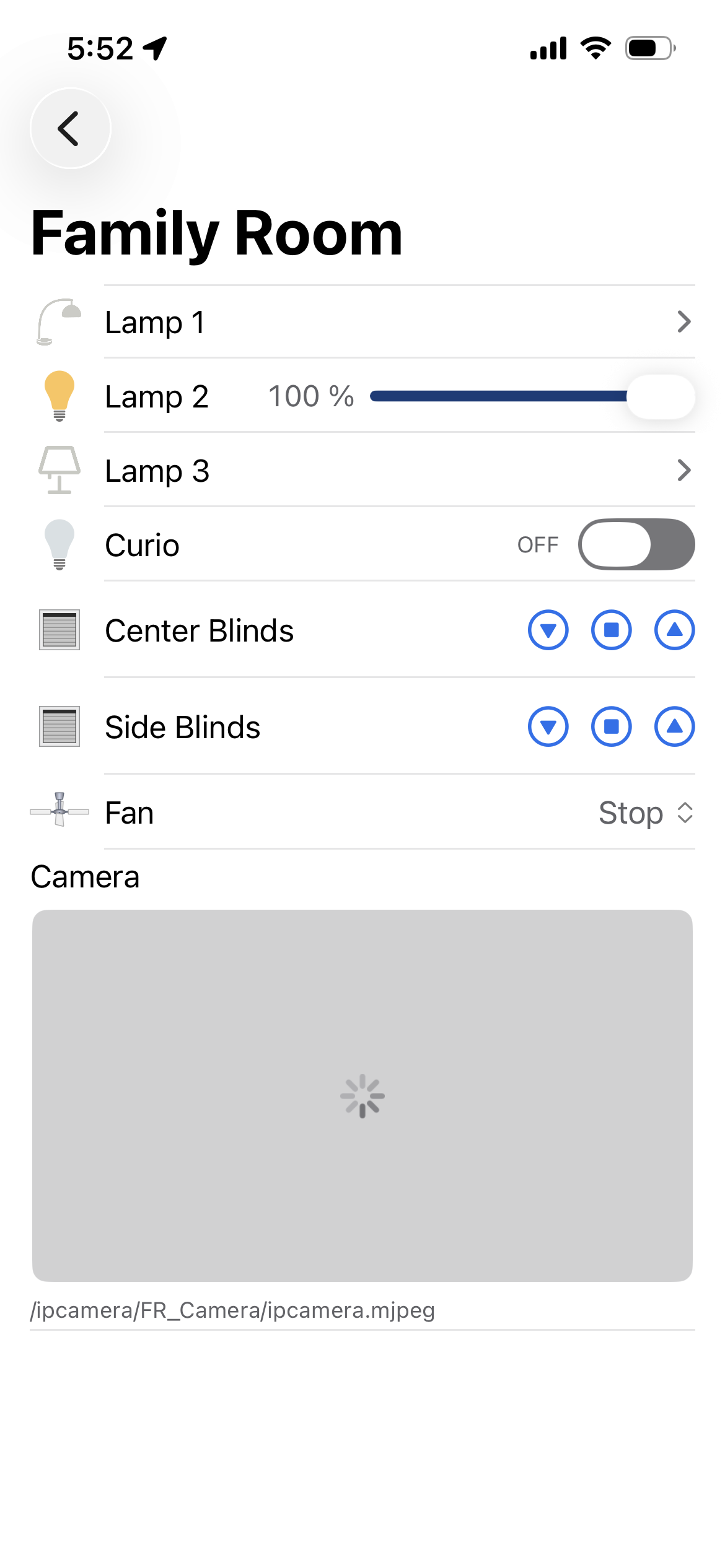

And this is what I get when I open the sitemap
What am I missing?
Thank you
The url is empty. You don’t need an item.

Thank you. I thought the item had the URL information so we could use the item or add the url to the definition. I’ll try doing it the way you suggest.
