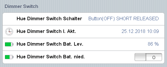

One hint for “Hue Dimmer Switch”:
I’ve created a hue.map transformation, with the following content:
1000=Button(ON) INITIAL_PRESSED
1001=Button(ON) HOLD
1002=Button(ON) SHORT RELEASED
1003=Button(ON) LONG RELEASED
2000=Button(DIM UP) INITIAL_PRESSED
2001=Button(DIM UP) HOLD
2002=Button(DIM UP) SHORT RELEASED
2003=Button(DIM UP) LONG RELEASED
3000=Button(DIM DOWN) INITIAL_PRESSED
3001=Button(DIM DOWN) HOLD
3002=Button(DIM DOWN) SHORT RELEASED
3003=Button(DIM DOWN) LONG RELEASED
4000=Button(OFF) INITIAL_PRESSED
4001=Button(OFF) HOLD
4002=Button(OFF) SHORT RELEASED
4003=Button(OFF) LONG RELEASED
and the corresponding item looks like:
Number 		HueDimmerSwitchButton		"Hue Dimmer Switch Button pressed [MAP(hue.map):%s]"	{ channel="hue:0820:xxxxxxxxxxxx:15:dimmer_switch" }
Now button state is “readable”.
Thanks for the hint. I will take care of that.
