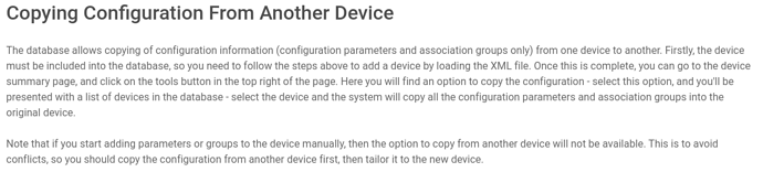

from the guide:
NOTE : If you find that there is already a device in the database with the same Type and ID as the one you want to add, don’t just change them or add duplicates. Please flag this to me on the openHAB forum and we’ll try and work out how best to handle it - for example, the device might be a newer (or older!) version of a similar device with different firmware.
Then, since most of the device config is the same, you can copy the config to a new device and then make the apropriate edits to the new version and submit for review.
Again, this is the process I used when I did the ZW132 device and everything worked well. Anyone that has more insight please correct me if there is anything wrong.
I think there’s an issue with the database when it imports files with the same type/id. To get around this, first edit the XML file to change the type/id to something “random” - 1234:5678. Then import the file, change the version of the old entry and also the version of the new entry so there’s no conflict, and change the type/id back to what it originally was.
From here, everything should be as normal. You can copy the configuration (parameters/associations) from the old version using the menu in the top right - note that this ONLY works if there are no parameters/associations configured so don’t add anything before doing this.
