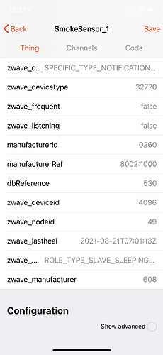

Hi @Spaceman_Spiff and @chris,
I have nine of them. I am at work, so I can send some screenshots of the Thing properties. If it does not help, I can send the XML later.
What do you think?
Bye
HFM
Thank you for your help and quick reply!
Unfortunately the screenshots are not enough.
It would be nice if you can post two or three xmls.

Thanks @HFM for providing the XML files. Unfortunately they show that the device presents exactly the same information as @Spaceman_Spiff HS3SA so there is absolutely no way to tell these two devices apart.
All I can therefore offer is to change the name of the device in the database from HS1SA to HS1SA/HS3SA.
