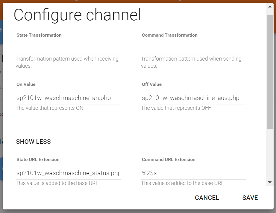

I want to use a switch channel, but im having problems with that.
The switch item is not showing the right state. Only UNDEF…
Switching on or off is working fine.

I looks like the response is right, but the switch is not updating to this state:
2020-11-21 13:46:39.043 [ome.event.ItemCommandEvent] - Item ‘EdimaxWaschmaschinePowerSwitch’ received command ON
2020-11-21 13:46:39.045 [nt.ItemStatePredictedEvent] - EdimaxWaschmaschinePowerSwitch predicted to become ON
2020-11-21 13:46:39.054 [vent.ItemStateChangedEvent] - EdimaxWaschmaschinePowerSwitch changed from UNDEF to ON
2020-11-21 13:46:51.033 [vent.ItemStateChangedEvent] - EdimaxWaschmaschinePowerSwitch changed from ON to UNDEF
Am I doing something wrong?
I thing you need to use a transformation map
you used your command values as Onvalue and Offvalue while you should use for your state value.
Therefore you should use a transformation map
So you can use:
OnValue:“ON” OffValue: “OFF”
Command Trasformation : “MAP:yourmap.map”
and in yourmap.map file
on=sp2101w_waschmachine_an.php
off=sp2101w_waschmachine_aus.php
or viceversa (I always forgot the right order)
Let’s try
Regards
Lorenzo
Yes. See my post #76 for a complete example how to use transformations.
Hi mstormi and foxejoe,
I ve read the whole thread :wink:
But the response for the state is still on or off like you can see in the trance log, so I thought i dont need a transform…
Or maybe i understand you wrong :smiley:
But nevertheless I will try it :+1:
Hi, this is not the problem… the problem is the command :wink:
In your configuration you set as status the command and as command you send the status therefore your command works but your status doesn’t.
You have to set the status on OnValue and Offvalue NOT the command !!
Read the example as mstormi wrote that explain better my point above.
Regards
Lorenzo
Hey Guys,
I got it!
It is working now :slight_smile:
But I do not really understand it!
But maybe the documentation at this point is not specific enough…

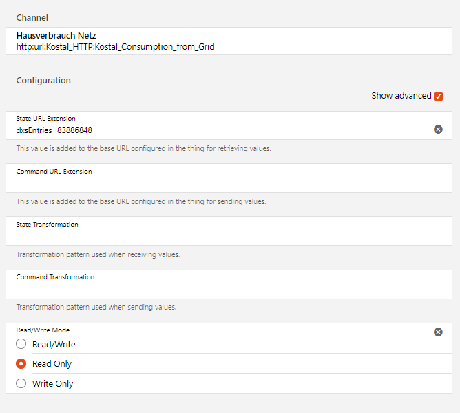

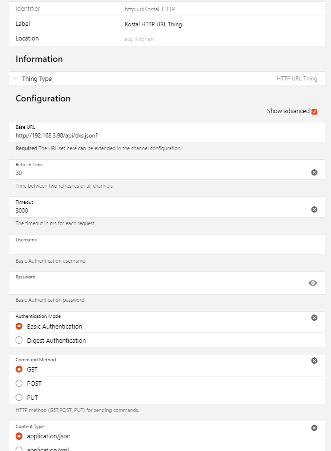

I’m acutally struggeling with the new binding on OH3. To make that clear : I have no clue what i’m doing here, i’m doing my best to understand these programming topics but its a far way unitl i really understand the basics. Mainly i’m trying and following examples i find in the wide web.
My actual problem is my PV inverter which i need to bring back into OH. WIth the old HTTP binding i had the following setup which worked perfect on my Kostal Piko BA8.
Under Services i had http.config file with the following path :
kostalCache1.url=http://192.168.3.90/api/dxs.json?dxsEntries=33556736&dxsEntries=83888128&dxsEntries=16780032&dxsEntries=33555202&dxsEntries=33555201&dxsEntries=33555203&dxsEntries=33555458&dxsEntries=33555457&dxsEntries=33555459&dxsEntries=33556226&dxsEntries=33556229&dxsEntries=33556238&dxsEntries=33556230&dxsEntries=33556228&dxsEntries=33556227&dxsEntries=83886336&dxsEntries=83886592&dxsEntries=83886848&dxsEntries=83887106&dxsEntries=83887362&dxsEntries=83887618&dxsEntries=67109120&dxsEntries=67110400&dxsEntries=67110656&dxsEntries=67110144
THe item files lokked like that :
//Home - Zusammenfassung
Number Kostal_0 “DC Eingang gesamt [%d W]” { http=“<[kostalCache1:30000:JSONPATH($.dxsEntries[0].value)]” , autoupdate=“false” }
Number Kostal_1 “Eigenverbrauch [%d W]” { http=“<[kostalCache1:30000:JSONPATH($.dxsEntries[1].value)]” , autoupdate=“false” }
Number Kostal_2 “Betriebsstatus [MAP(kostal_status.map):%s]” { http=“<[kostalCache1:30000:JSONPATH($.dxsEntries[2].value)]” , autoupdate=“false” }
With the new binding i have included the following thing :
The channels look like that ;
Trace shows me that values arrive
2020-11-23 12:29:58.463 [TRACE] [p.internal.http.HttpResponseListener] - Received from ‘http://192.168.3.90/api/dxs.json?dxsEntries=33555458’: Code = {200}, Headers = {Content-Type: text/plain, Expires: Sun, 02 Jan 2000 11:11:11 GMT}, Content = {{“dxsEntries”:[{“dxsId”:33555458,“value”:492.231293}],“session”:{“sessionId”:0,“roleId”:0},“status”:{“code”:0}}}
2020-11-23 12:29:58.471 [TRACE] [p.internal.http.HttpResponseListener] - Received from ‘http://192.168.3.90/api/dxs.json?dxsEntries=33555459’: Code = {200}, Headers = {Content-Type: text/plain, Expires: Sun, 02 Jan 2000 11:11:11 GMT}, Content = {{“dxsEntries”:[{“dxsId”:33555459,“value”:0.000000}],“session”:{“sessionId”:0,“roleId”:0},“status”:{“code”:0}}}
2020-11-23 12:29:58.472 [TRACE] [p.internal.http.HttpResponseListener] - Received from ‘http://192.168.3.90/api/dxs.json?dxsEntries=83886848’: Code = {200}, Headers = {Content-Type: text/plain, Expires: Sun, 02 Jan 2000 11:11:11 GMT}, Content = {{“dxsEntries”:[{“dxsId”:83886848,“value”:3933.464355}],“session”:{“sessionId”:0,“roleId”:0},“status”:{“code”:0}}}
2020-11-23 12:29:58.495 [TRACE] [p.internal.http.HttpResponseListener] - Received from ‘http://192.168.3.90/api/dxs.json?dxsEntries=33555457’: Code = {200}, Headers = {Content-Type: text/plain, Expires: Sun, 02 Jan 2000 11:11:11 GMT}, Content = {{“dxsEntries”:[{“dxsId”:33555457,“value”:0.000000}],“session”:{“sessionId”:0,“roleId”:0},“status”:{“code”:0}}}

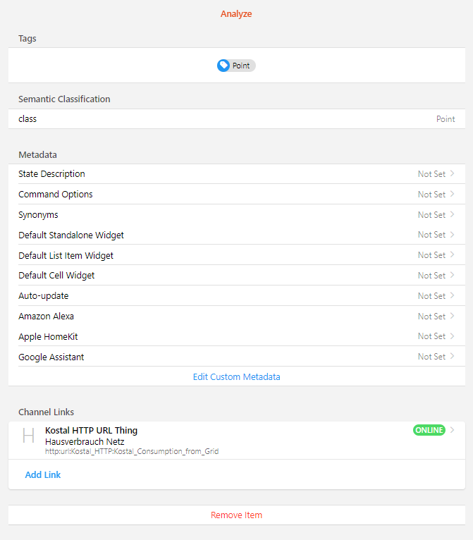

Then i link a new Item to the channel
But i always get either NULL or UNDEF as output of the item
I assume i need to enter something somewhere to transfer the value to the item but i have no clue what i have to enter and where…
If i use JSONpath on the link between Channel and item i’m asked for a JSONPath Expression. My assumption is that i need to enter something there but what ? :wink:
Most probably thats something very stupid and easy if you know what you do…
