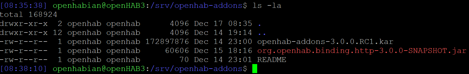

I tried to put the jar in the /srv/openhab-addons directory and get this:
but, there’s no http-binding available in the UI. Did I miss something?

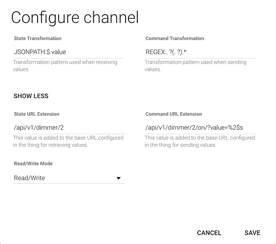

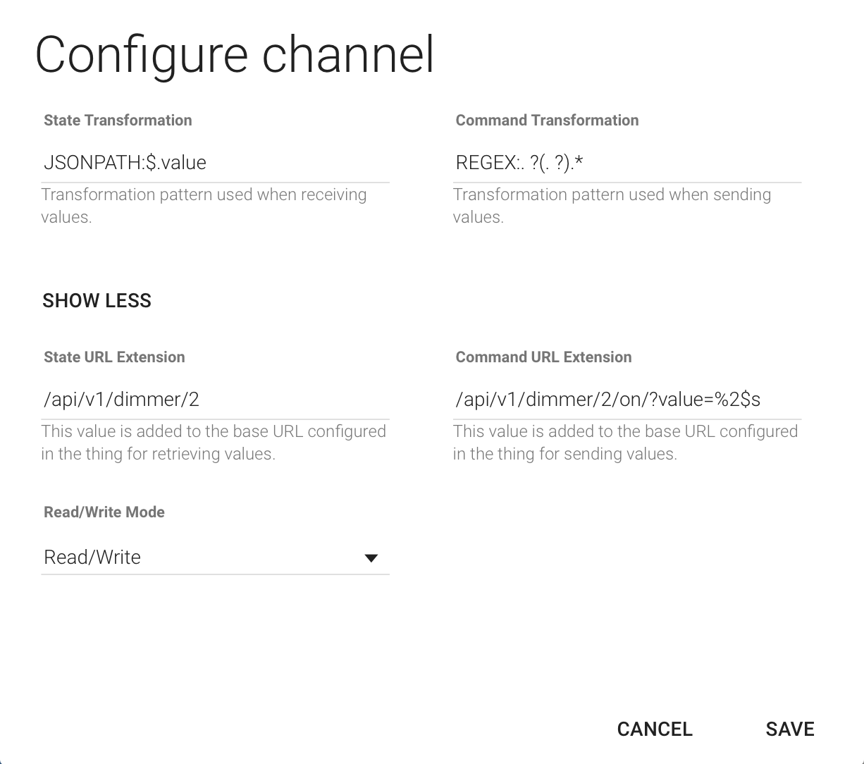

Hi
I cannot figure out how to configure the channel to set a number value.
I get the value from the state, means there must be something with the command transformation or Command URL extension.
In Postman, this works:
POST: http://{{ip}}/api/v1/dimmer/2/on/?value=30
Item:
Number		dingzDimmerValueWohnzimmer
			"Wohnzimmer [%d]"
			<slider>
			(gPersist) {channel="http:url:dingzWZ:dingzDimmerValueWohnzimmer"}
sitemap:
		Switch	item=dingzDimmerValueWohnzimmer mappings=[0="AUS", 12="MIN", 30="MID", 55="MAX"]
		Slider  item=dingzDimmerValueWohnzimmer label="Helligkeit" minValue=12 maxValue=55 step=1
EDIT1: I removed the spaces in the ā€œCommand transformationā€, I also tried with ā€œREGEX:(.*)ā€
EDIT2: I guess the transformation works, I’m using now ā€œREGEX:(.*)ā€
2020-12-18 17:51:01.747 [DEBUG] [.internal.RegExTransformationService] - about to transform '30' by the function '(.*)'
2020-12-18 17:51:04.671 [DEBUG] [.internal.RegExTransformationService] - about to transform '12' by the function '(.*)'
2020-12-18 17:51:08.945 [DEBUG] [.internal.RegExTransformationService] - about to transform '55' by the function '(.*)'
2020-12-18 17:51:14.982 [DEBUG] [.internal.RegExTransformationService] - about to transform '22' by the function '(.*)'
2020-12-18 17:51:20.166 [DEBUG] [.internal.RegExTransformationService] - about to transform '28' by the function '(.*)'
2020-12-18 17:51:22.843 [DEBUG] [.internal.RegExTransformationService] - about to transform '40' by the function '(.*)'
Any hints regarding the command stuff ?
EDIT3: it works that way. I just forgot to switch the thing command method to POST

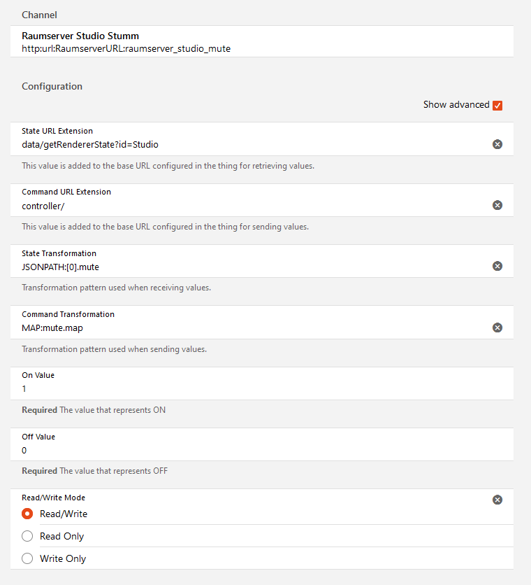

Hi
I have this channel configuration and the following mute.map file but the controller only gets a request for ../controller/ and not for the full path on mute/unmute
0=unMute?id=Studio
1=mute?id=Studio
Any idea what the ideal configuration should look like?
If you want to add the transformed value to the URL you need to add %2$s to the commandExtension.
did you get it to work?

Now for the Volume I have a number in
$.data[:0].rooms.1.Volume ( JSON Path Validator)
but if I input that into state transformation I get undef on the item.
Please show the full response that you would like to transform.
