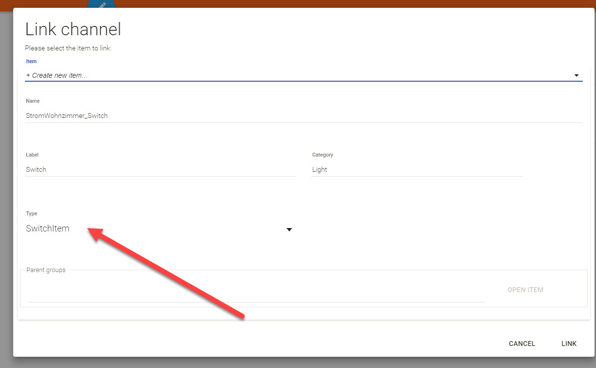

today I got an Osram Smart Plug and connected it to my hue bridge. Then I added it as Thing using Paper UI. But the accepted item type for this Thing is “SwitchItem”. Shouldn’t it be “Switch”. I cannot assign any item, Where does the accepted item type come from and can I fix this somehow? Looks like a bug here.
The first screenshot shows the Thing with the accepted item type “SwitchItem”. (all my other Swith Things have “Switch”). If I try to create an Item from here also the ItemType “SwitchItem” is used. The creation fails with “invalid ItemType”
