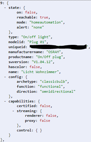

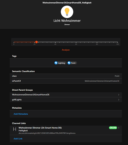

Issue 1: I want several dimmable lights exposed and since all lights showed up as “on/off light” only, I added the “Lighting” tag according to the documentation:
Nonetheless, they still show up as “On/off light”:

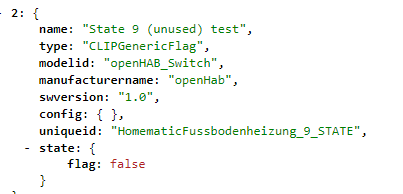

Issue 2: There are WAY too many items exposed as “sensors” and I caanot even think, why some things are exposed. I tried the “internal” tag according to documentation, but they still show up:
