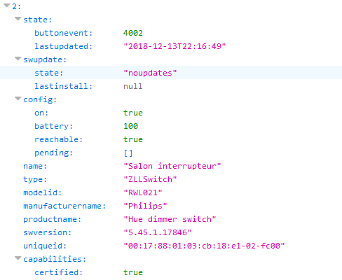

I’m trying to integrate switches and hue presence detector in my setup, but openhab does not see them.

json from bridge :
thanks in advance
Sensor support was added in openHAB 2.4
thanks a lot, i updated to 2.4 and everything works :wink:
