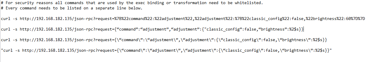

thank you for this helpful post. I configured the exec thing exactly like you explaned. I put the command in the whitelist but OH tells me, that the command is not in the whitelist. I put different formatted commands in the whitelilst but this doesnt solve the problem.
Please have a look at the attached whitelist.
error
I don’t use the exec binding, but you have definitely the wrong quotation marks in your whitelist (maybe even in your other code):
See “ (wrong) versus " (correct)
The wrong quotation marks are also in Rich’s proposal, maybe he used an external editor.
Thats why i have four different entries for one command.

I think @sihui has why the white list isn’t working. Did you copy these from somewhere?
Text editors that like to make things look nice will often replace the quotes. For example this forum does that: "stuff" vs. “stuff”. Notice how the quotes are different.
The fancy quotes won’t work.
This needs to be fixed in both the Exec Thing and the whitelist. The shell where the command actually runs can’t handle the fancy quotes.
This may have been partially my fauly because I just copied the URL from the forum without paying attention. When you don’t use code fences, the forum will replace the standard quotes with fancy quotes.
This is wrong
curl -s http://192.168.182.135/json-rpc?request={“command”:“adjustment”,“adjustment”:{“classic_config”:false,“brightness”:%2$s}}
This is correct.
curl -s http://192.168.182.135/json-rpc?request={"command":"adjustment","adjustment":{"classic_config":false,"brightness":%2$s}}
Notice how even the forum treats the fancy quotes and standard quotes differently in the sybntax highlighting.
It’s one of the reasons that using code fences is so important .

2025-03-04 17:09:02.666 [WARN ] [ng.exec.internal.handler.ExecHandler] - Tried to execute ‘curl -s http://192.168.182.135/json-rpc?request={“command”:“adjustment”,“adjustment”:{“classic_config”:false,“brightness”:%2$s}}’, but it is not contained in whitelist. It is definitly in the whitelist.
maybe you can try to start with a simpler version of your command. Just exec the following command and add the same “short” version to your whitelist
I know it will not have the effect you want, but you can check at least if the whitelist is working. If it is not triggering the “whitelist error” add some additional parts from your final url, until you get the whitelist error again. Then you know where or which character exactly was the problem.
I would try the following command version, one after the other
curl -s http://192.168.182.135/json-rpc?request={"command":"adjustment"}
Whitelist is working, as I tried with another command.
Ok. let me rephrase. I don’t want to test whether the whitelist works in general. I would test up to which character of your command the whitelist works
Sorry, but i tried once more with your suggestion and the whitelist doesnt seem to work.

Please post the actual text from logs and the whitelist and such instead of screen shots. Screen shots are really hard to work with. Use code fences to preserve white space and keep the forum from messing with the text (e.g. fancy quotes).
code and logs go here
When showing the Thing, click on the code tab and paste the yaml you fing there.

For me it looks like still using the wrong quotation marks. What codepage does your editor use ?
I removed anything exept my desired command and now it works.
The fancy quotes may have messed up the witelist parser somehow. I don’t know that code.
It might be worth an issue if we can show that’s the case, though no shell is going to accept a command with fancy quotes anyway so maybe adding the ability to detect them isn’t needed?
