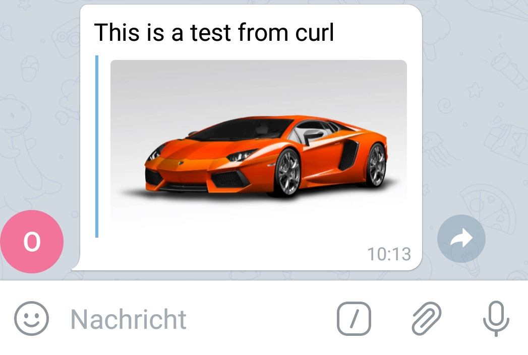

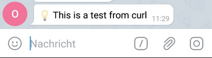

The only option that I see that should work is sending a html formatted message. The message then needs to include a link to an icon. In case there is a UTF-8 or UTF-16 symbol for the lamp it even might work better. As pictures are being shown as preview.
