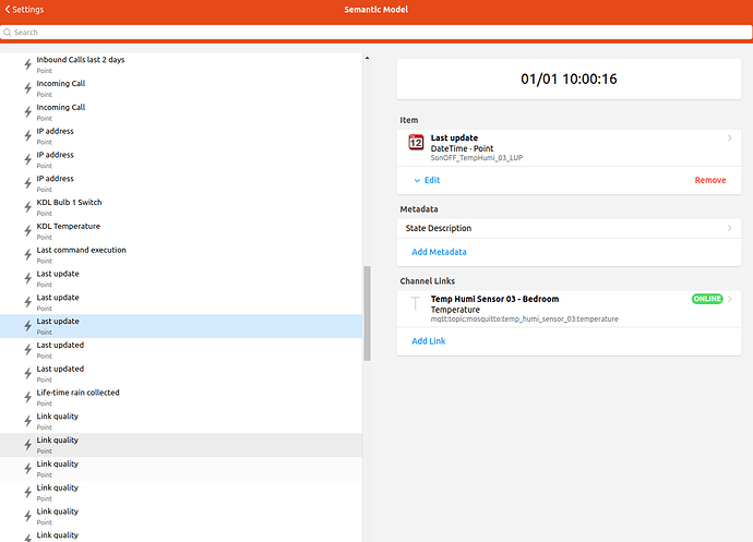

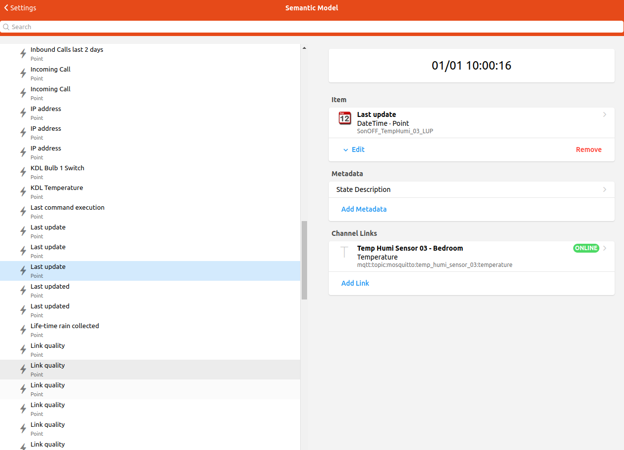

I found this post, which at least describes how to get to the profile assignments.
I have never been there; Model that is.
It looks like this:
I see only 5 “Last update(d)” points, but have probably 50 of them; where are the others?

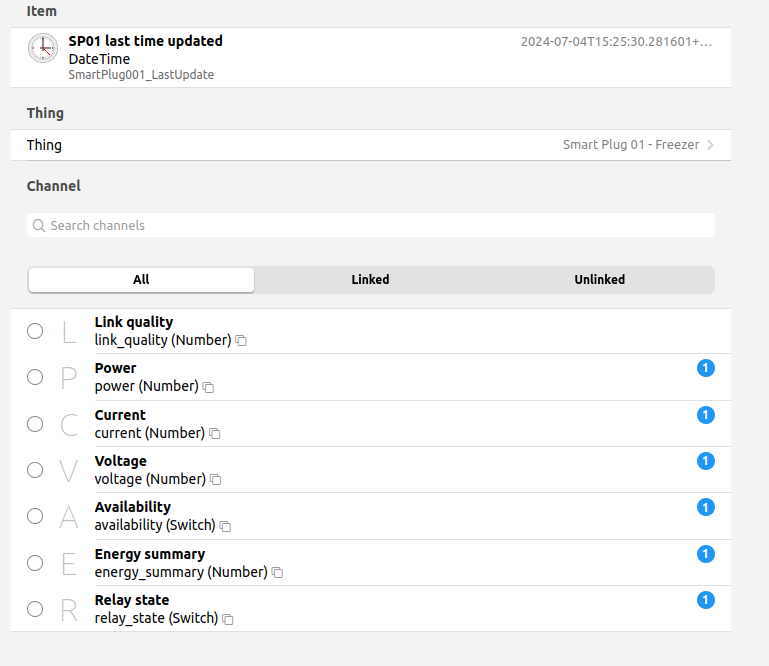

This screenshot also shows a date item linked to a number channel, which is what I cannot do anymore on newly created (MQTT Generic Thing) channels.
See here:
WHAT?!
Now it lets me!!!
Dang.
Did I make to many change and the JSON db had to catch up?!!!
What is going on here?

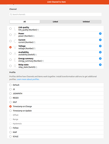

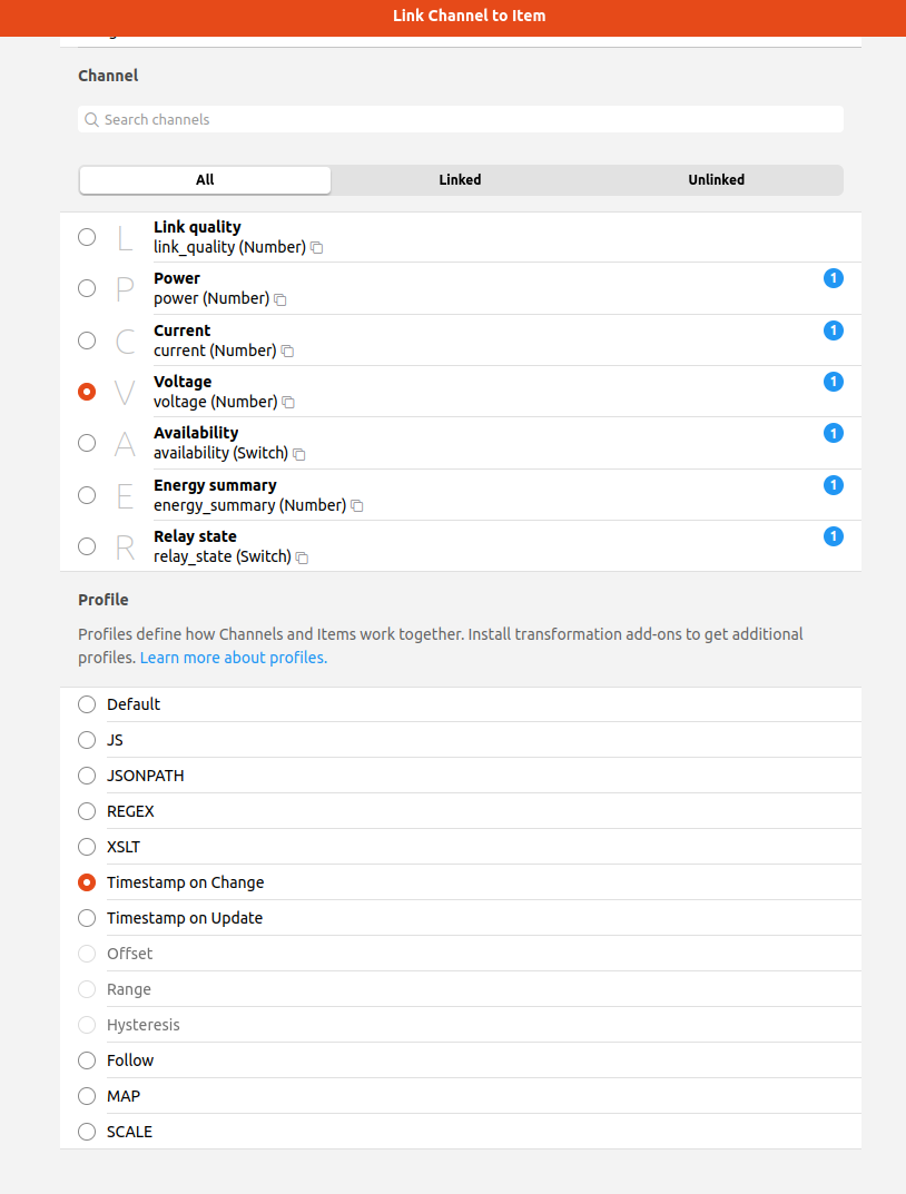

Sometimes I should look better
It is right there…
