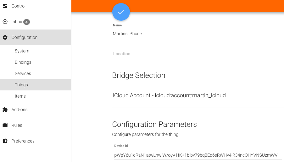

In case you have not found the Device ID yet. Go to the Paper UI. Press Configuration->Things->“Your iCloud Device”. You will now see a blue pen icon. Press that and you will find the Device ID under the Configuration Parameters.
