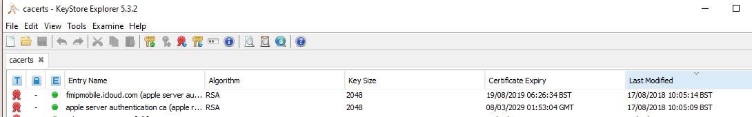

I have tried Patrik’s solution with no luck.
I have a windows machine so KeyStore Explorer looked the simplest for me.
I Imported both the Certs, rebooted the computer but still no luck getting this running.
If I reload Keystore Explorer it looks like both have imported ok!

Wow,
Finally got this sorted and can’t believe my school boy error!
I have got “JRE” and “JDK” on my machine and didn’t realise KeyStore Explorer was only updating “JRE”.
I finally forced KeyStore Explorer to open the other folder and it has worked.
Hopefully this method will work for others with ongoing problems.

Thank you very much for support in advance.
Had the same problem “Certificate not imported, alias already exists”, in that case on a Synology machine.
Having a look at post #53 procedure I realized my mistake.
I checked where my java is located and by doing a “which java”. I found it in
/volume1/@appstore/Java8/j2sdk-image/bin/java
So i used this to change the directory to.
WRONG! There is another java folder, the one which is relevant here:
/volume1/@appstore/Java8/j2sdk-image/jre/bin/java
So java exists two times :frowning:
Correct procedure on my Synology is:
echo -n | openssl s_client -servername fmipmobile.icloud.com -host fmipmobile.icloud.com -port 443 -prexit -showcerts 2>/dev/null | sed -ne '/-BEGIN CERTIFICATE-/,/-END CERTIFICATE-/p' > /tmp/icloud2.crt
cd /tmp
csplit -f cert /tmp/icloud2.crt '/^-----BEGIN CERTIFICATE-----/' {*}
cd /var/packages/Java8/target/j2sdk-image
bin/keytool -importcert -file /tmp/cert01 -alias icloudfmi1 -trustcacerts -keystore ./jre/lib/security/cacerts -storepass changeit
bin/keytool -importcert -file /tmp/cert02 -alias icloudfmi2 -trustcacerts -keystore ./jre/lib/security/cacerts -storepass changeit
Several files are splitted, but the keytool should really run only twice.
I hint for checking imported certificates is to check the date+time of the certificates file
/var/packages/Java8/target/j2sdk-image/jre/lib/security/cacerts
iCloud Binding including .things and .items is running since today after update to latest snapshot
openHAB 2.4.0~20181106171044-1 (Build #1414).
Now I can start with Presence detection by iCloud. Thanks for again good job to @martinvw.
Please note that all workarounds above should not be needed anymore when using the snapshot version, because some changes in the framework and the binding were merged which resolve this.
My local environment is completely happy (without any workarounds) :slight_smile:
