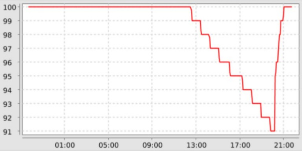

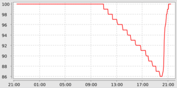

Now I was interested, after I had read here of the many battery consumption, how big this is?
I had a test iPhone SE configured for this as follows:
  • The device had only the basic device configurations after reset.
  • Mobile → connected to 4G (3-4 bars)
  • Wi-Fi → on and connected (good connection)
  • Bluetooth → off
  • Location service → on
The battery was always fully charged (100%) for the test and operated for exactly 12 hours on battery power (8 am to 8 pm).
  1. Without iCloud integration, the battery still had 95% after 12 hours
  2. With iCloud integration and a refresh interval of 10 min. still 91%
  3. With iCloud integration and a refresh interval of 5 min. still 86%
From this it can be deduced, for the iphone SE, that within 12 hours the battery consumption by the iCloud binding with a refresh time of 10 min. → 4-5% and at 5 min. → 9-10%.
