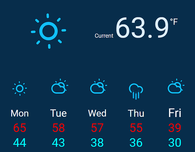

Installed the new icons today from your release and everything looks good. Granted, the forcast is sunny for the week :slight_smile:

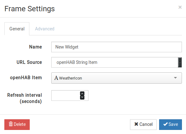

And in HABpanel:
A frame widdget with the following settings:
