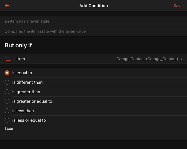

I mean, for example, compare the temperature received in a sensor with a target temperature stored in an item (whose value can be calculated in another rule).
Technically it can be done, however, doing so would make the UI more complex.
I’d imagine:
  • Add a radiobutton that says
    • Compare against a literal value, or
    • Compare against an item state
  • And if it’s an item state, present an item Picker
I’d suggest using a script condition in this case. I’m not sure if RulesDSL supports this syntax, but you can pick JRuby and write this very simple statement:
Item1.state >= Item2.state

This one here?
Or this one?
Do you have a proposal for how the UI could meet your requirement whilst at the same time keeping the UI simple for new / “non advanced” users?

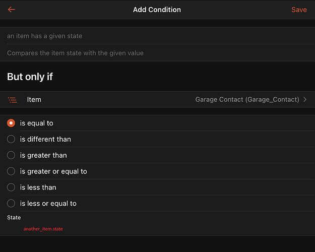

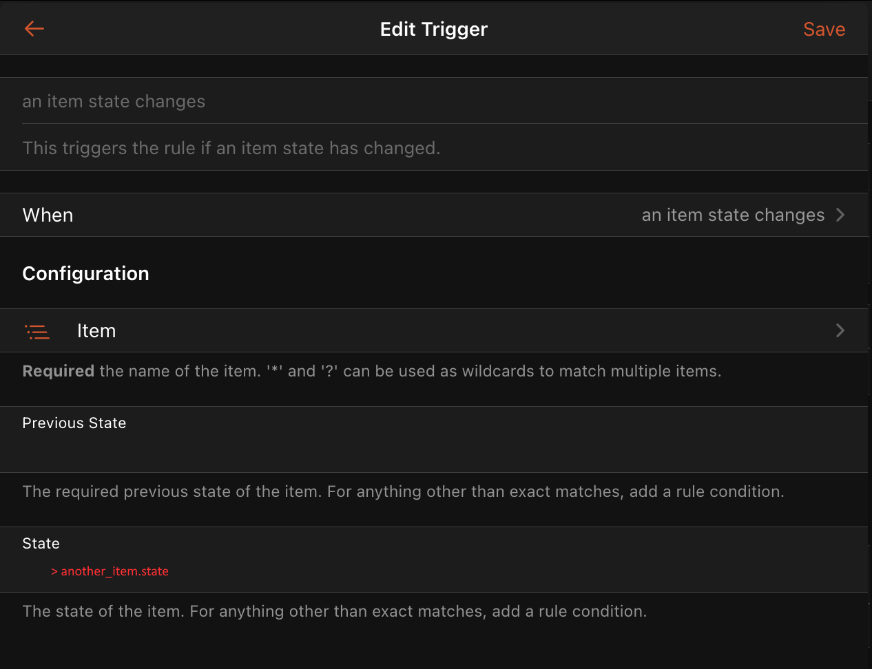

For me this would be perfect
Not necessarily with a another_item picker.
But, alternatively, it could be also as

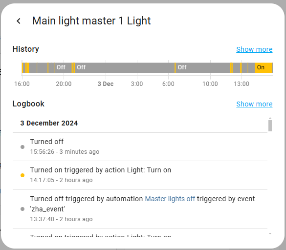

I know some people really hate that HA gets mentioned, but Home assistant does that well - maybe opnenhab could implement that as well?
It would be kinda like a logbook/log filter per item, that has entries like
Item x changed from a to b from source c (e.g. from rule xy, from thing update x, from User input, …).
And no, I dont want to switch to home assistant. But its a nice feature that’s maybe worth adapting.
Thanks for the tip. Somehow it doesn’t seem easier than what I’m doing today though :joy:
Never tried HA, but yes, that looks exactly like I’m thinking it would!
