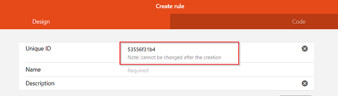

That soundslike an auto-created UID for a DSL rule found in respectivefolder. OH3 parsed this rule and gave it an UID (with an unique name). When creating a rule you can changed that during thei itial creation. The auto-created ones however can’t be edited.
How can I change this during the initial creation? Can you give me a hint?? @opus
Have you tried?
