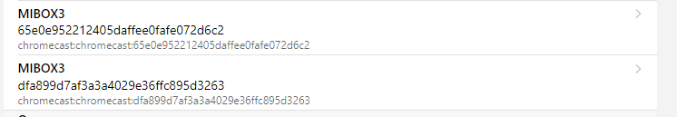

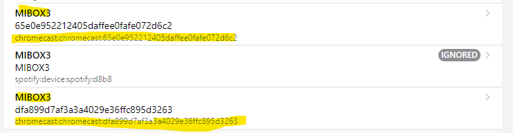

I think it should not happen, but what I see in my setup is that sometimes “new” devices appear that are actually the same and this is because of different IDs, example:
Both are entries by the chromecast binding for the same device, while other previously as “ignored” entries stay hidden for me:
Thanks @chrismast - unfortunately this appears to be a different problem for me. There are no item sin my ignored items anymore.
