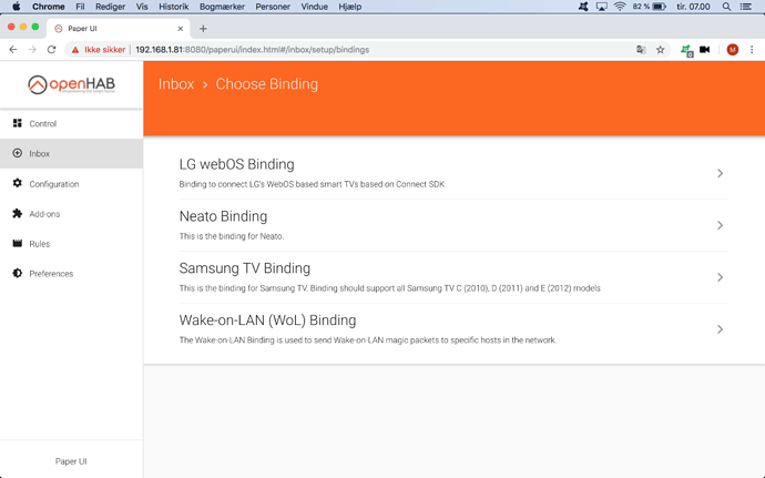

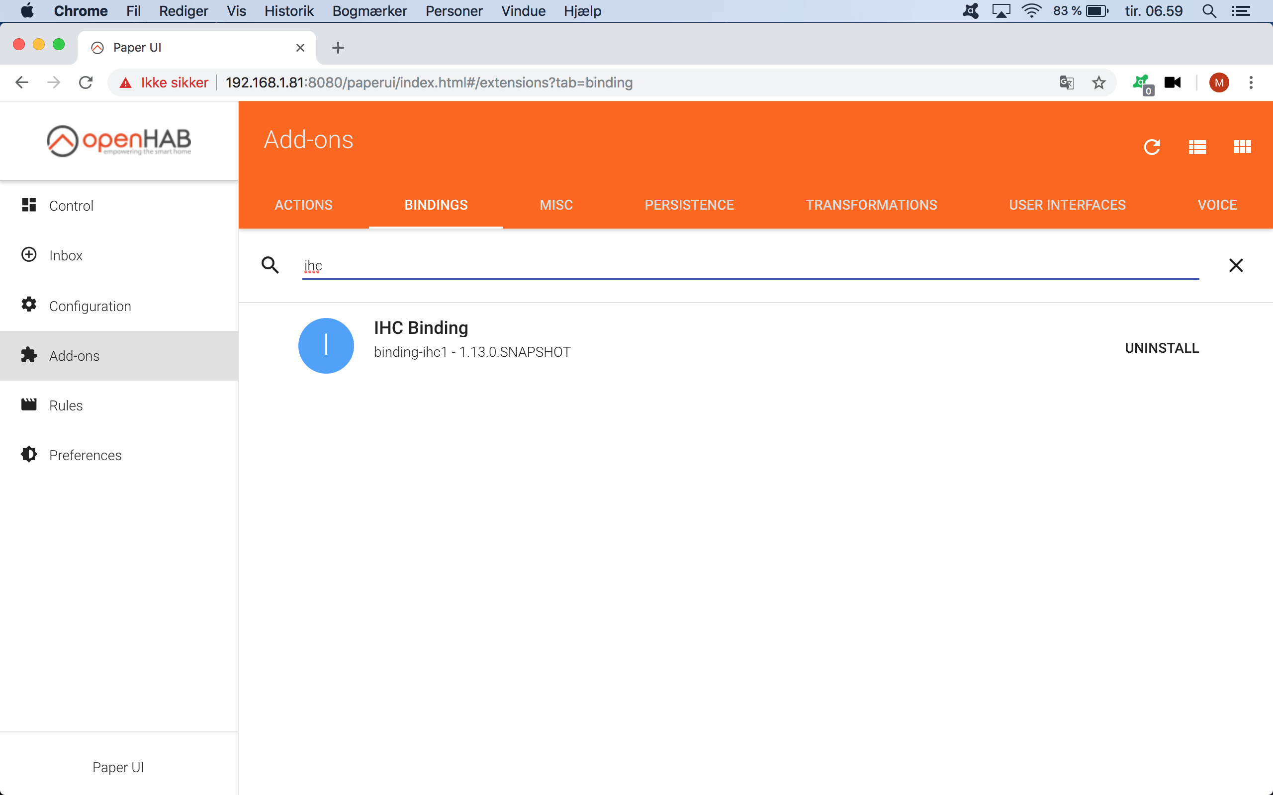

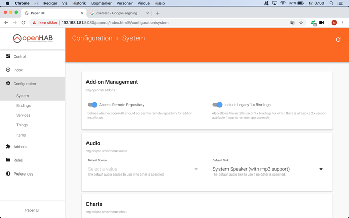

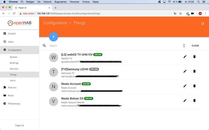

I have installed IHC binding. Enabled Legacy 1.X Bindings. But I can not see the IHC controller in the inbox or under things?
I have also filled in the ihc.cfg file with the IP address, user and password.
Are there any who have an idea of where things can go wrong?
Legacy (1.x) bindings like the IHC do not support Discovery and/or Things concept and as a result, you won’t see anything in Inbox or in PaperUI->Conf->Things.
