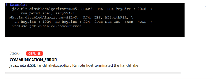

Update: No handshake problems ,but some communication issue stil exist.
Setup is a PI 4 ,with Openhabian and Openhab 3.2M3
i am getting error messages ,and cant control the IHC controller .
These are the current messages. not sure where to start
