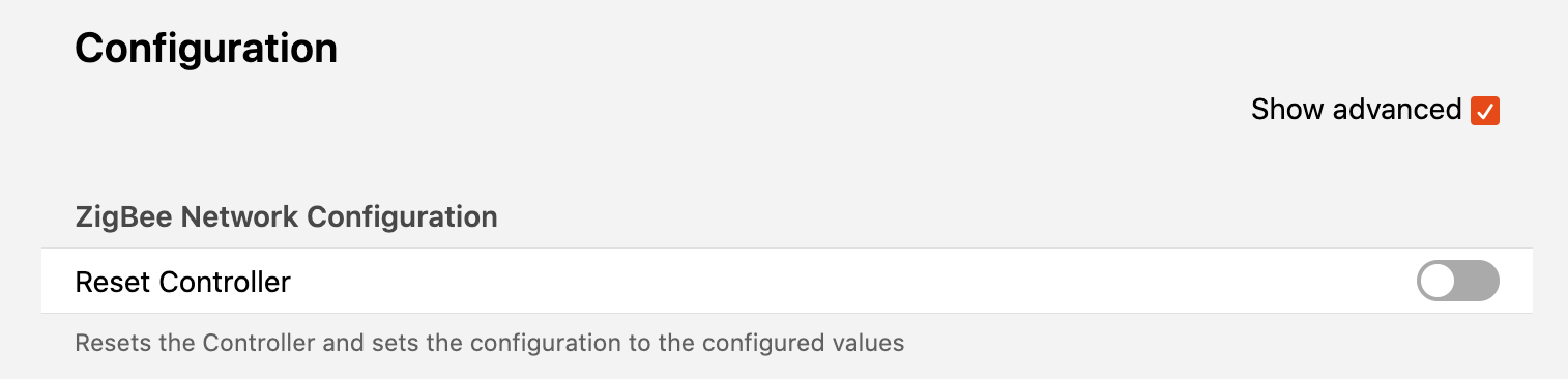

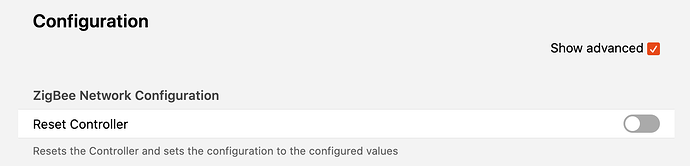

How do I reset the coordinator?
Isn’t there an option in the coordinator configuration to do this? I don’t have this in front of me, but I thought there was an initialise option?
You are right, it was hidden behind the ā€œshow advancedā€ checkbox.
I’ll try a reset and empty the cache. But first I need some coffee… :wink:
I think ticking this ought to also clear the cache as the framework does clear the device database, but it doesn’t hurt to be sure :wink:
