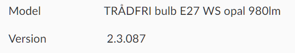

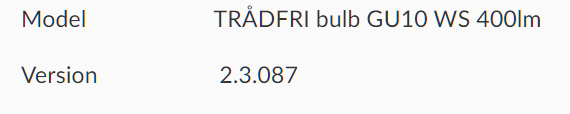

I bought a number av Trådfri E27/GU10/Floalt WS devices when they were first released and have since day 1 had trouble with them randomly dying off. Stuck OFFLINE in either ON or OFF state. Had to be power-cycled. Amongst the 30+ devices, 1-2 died off each week. This was on FW 1.something
After update to 2.3.087 (through deconz) all have been rock solid for more than 3 weeks now.
