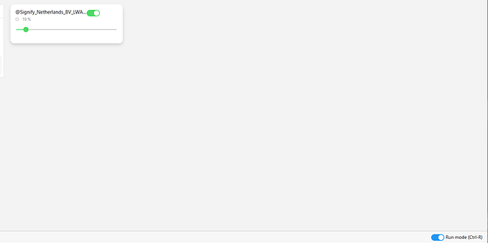

I’m using 5.0.2 and this is my code, which fails to display the items ‘label’ for my Dimmer and Switch lights.
Can someone suggest a modification please? I’m pulling my hair out.

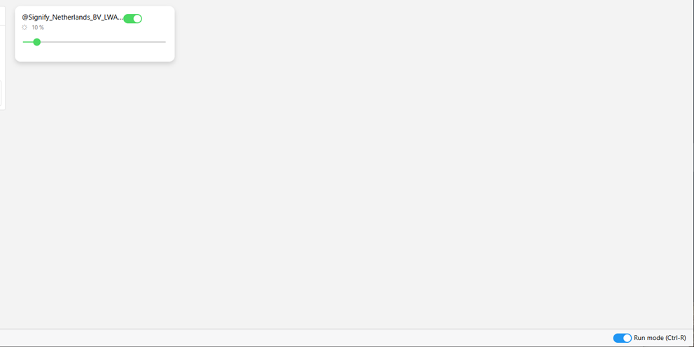

Not seeing a issue using your code on my openhab install
All I had to do to see the label was change it from white to black.

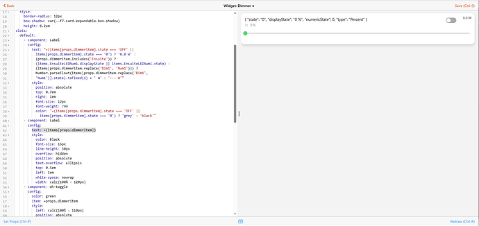

Yes, and as also stated the item label value is not available if you opened widget editor and replaced this line
text: ="@" + props.dimmeritem
with
text: =(items[props.dimmeritem])
your widget would show you all the available items you have for that item.
so using my example widget from above it would show you this for that labels value.
as you can see there is no choice for a items label value as an option to select.

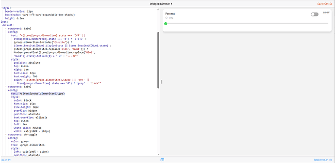

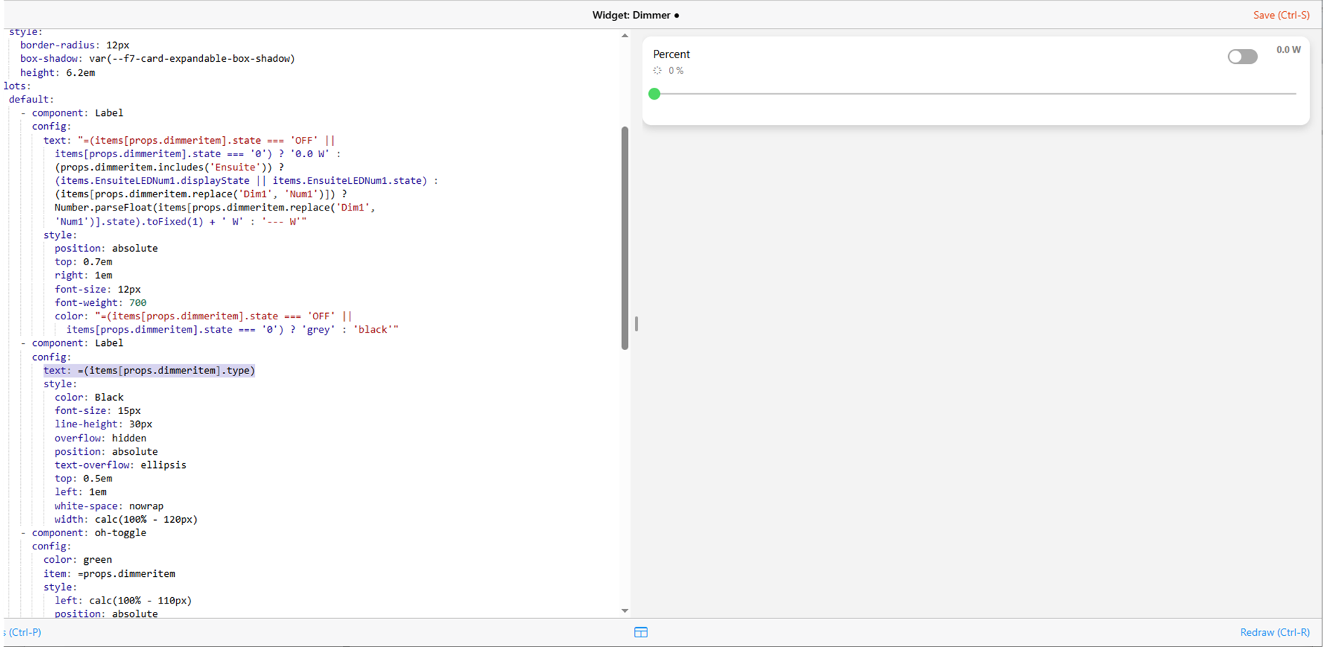

if you added
text: =(items[props.dimmeritem]).type
you would see this as the label
and so on for each of the exposed possible choices your selected item exposes.
notice there is no option for
"label:(*your labels value*)"
so, it is not exposed thus it cannot be referenced within the widget easily.
