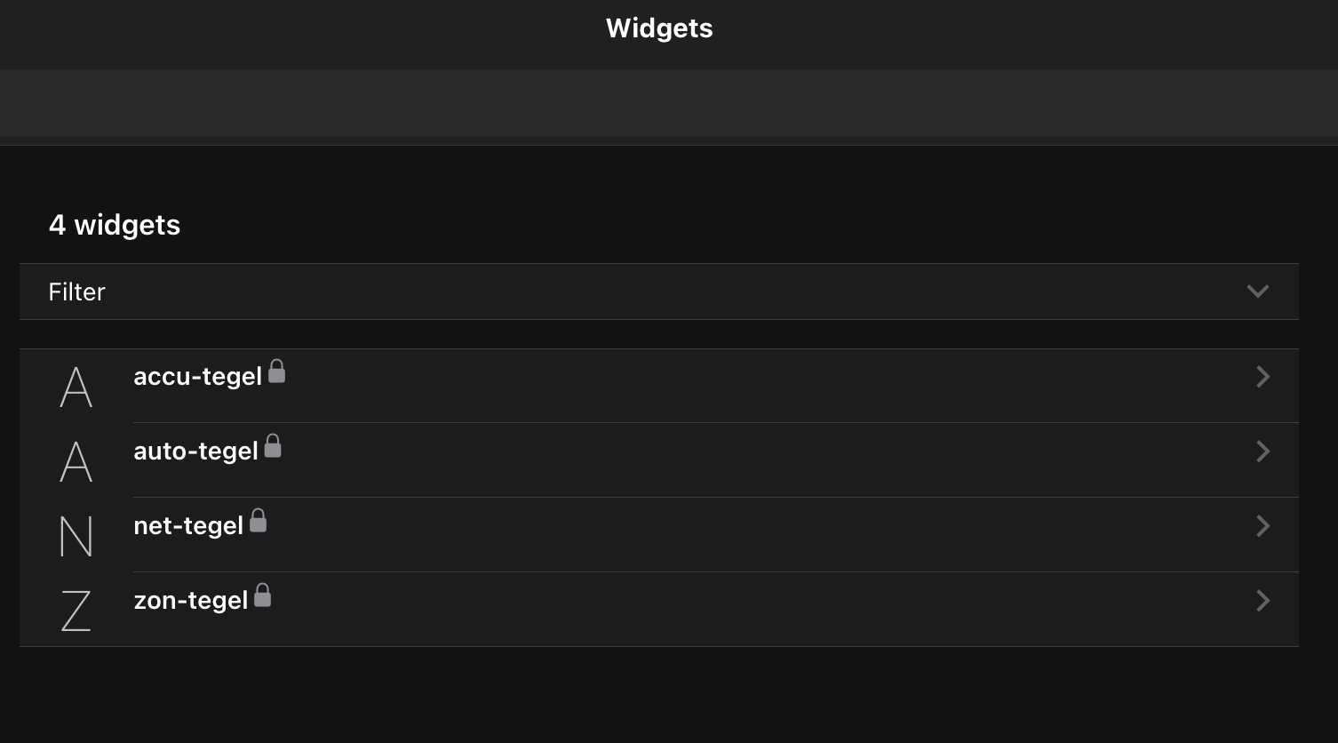

  1. Lock icon: widgets loaded this way show up in Developer Tools > Widgets with a small lock icon next to them. I assume this indicates they’re read-only / externally managed (i.e. coming from a file, not the managed/GUI store) - can someone confirm this is indeed what the lock means?

They appear in the Widgets list page
  1. Then I deleted those 4 files. The widgets list after hitting refresh, show no widgets

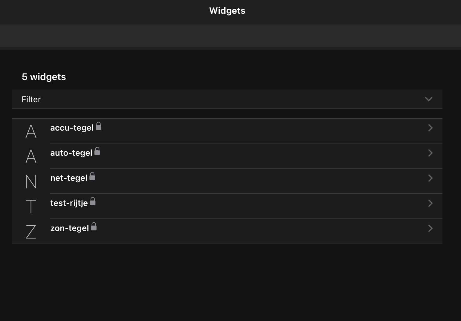

They appear in widgets list (again, I had to refresh the page)

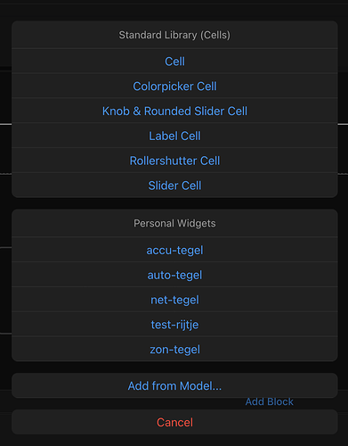

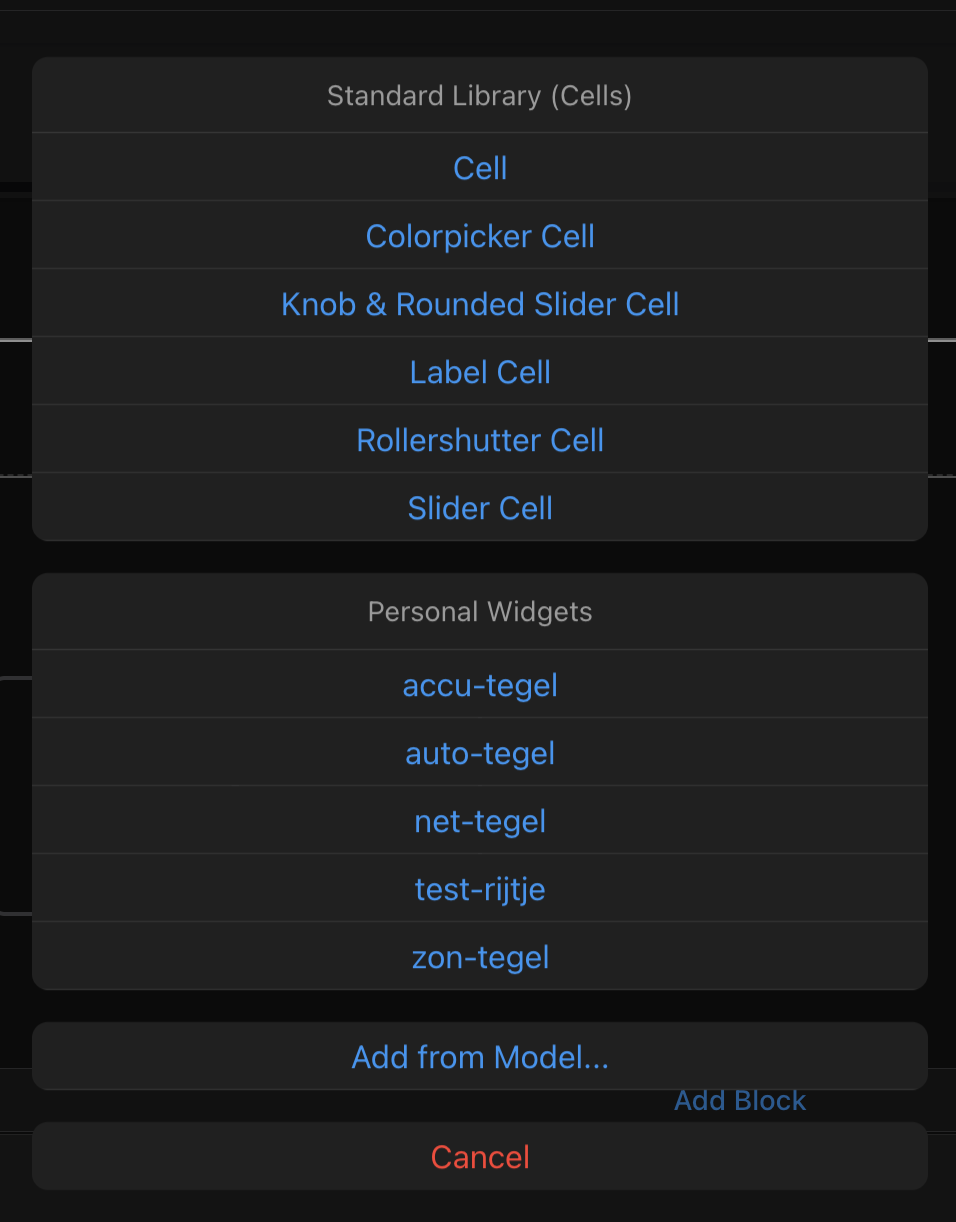

  1. They also appear in the list of widgets that I can add to a page:

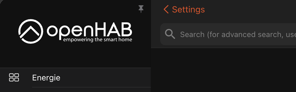

I ran into something with pages that I can’t fully explain. My energiepagina_compleet.yaml file loads without errors in the log, but the page does not appear in the sidebar. I had originally given it a readable UID:
uid: page_energie_bestand
When I replaced that UID with a GUI-style auto-generated one:
uid: page_1bc8ca20f2
…the page suddenly shows up in the sidebar and renders fine (screenshot attached — the widgets are empty because the referenced items don’t exist in this test, but the layout is there).
Is there a naming convention or specific pattern that page UIDs must follow to be picked up by the sidebar? It looks like only UIDs matching the auto-generated page_ + hex pattern are recognized, but I couldn’t find this documented anywhere. Or is this a bug?
