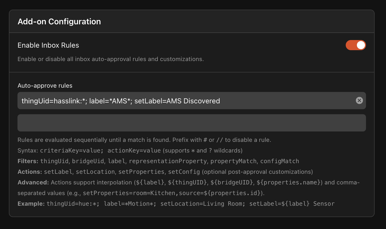

Would it be useful to have a set of rules to automatically approve inbox items, turning them into Things? I’ve built this add-on but haven’t submitted it yet - unsure whether it’s something that’s needed.

Configuration
Configure the add-on through Main UI under Settings → Add-on Settings → Inbox Rules, or set rules in ConfigAdmin. Each entry is one rule:
Set rulesEnabled to false to disable all rules; it defaults to true.
criteriaKey=value; actionKey=value
Rules are evaluated in order; the first matching rule approves the result.
A rule without action keys only approves it.
Lines beginning with # or // are comments.
Invalid rules are ignored.

Example:
# Approve a discovered device and enrich it
thingUid=zwave:device:*; label=Front Door Sensor; setLabel=${label}; setLocation=Ground Floor; setProperties=room=Entry,serial=${properties.serialNumber}
