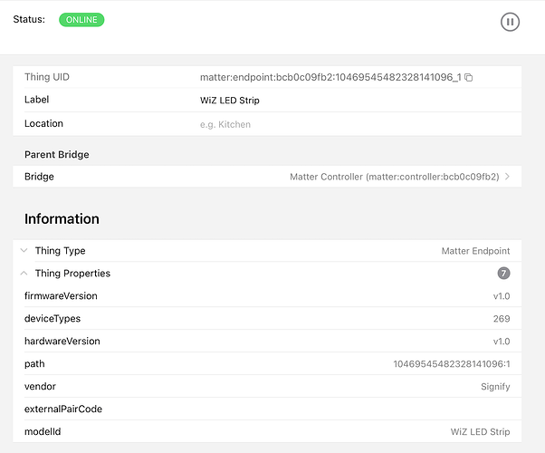

Did you check your thing status ? Is it always ONLINE? Especially when you encounter problem with the ON/OFF command.
I will need to see DEBUG logs when you switch it on and when you switch it off from openHAB. It also might be helpful if there is a log when switching off from Apple in openHAB when its not working. Also what does the item look like you are sending an OFF command to ? Is this the color item?

I operate on the colorcontrol-color channel/the color item. I am switching the lamp via a scene that sets hue, saturation & brightness (in a rule triggered via a Philips Hue Wall switch). Off is done also in the same rule also triggered via a wall switch module by doing an item.sendCommand(âOFFâ).
When the error occurs, the item is marked as âonlineâ in OHâs GUI.
Here a screenshot:
