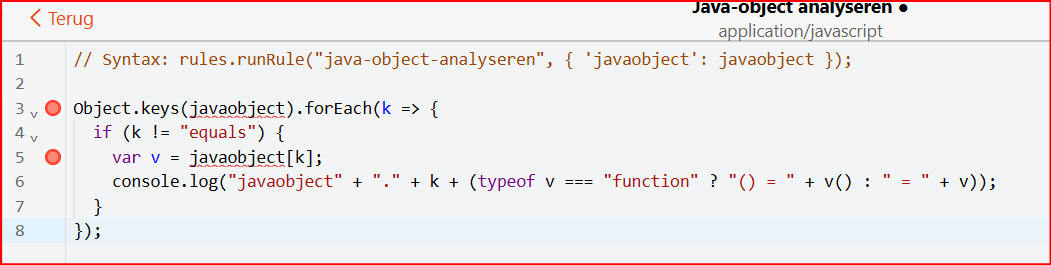

But I’ve got a few scripts, which I call in other scripts or in rules, and to which I pass a few arguments. And if I use one of these parameters, the code editor complains that they’re not declared yet. Understandable, but a bit annoying:
Is there a way to “tell” the editor that these parameters will be passed through as arguments? Or should I open an issue for this on GitHub?
Try using ctx.javaobject instead of just javaobject. Apparently that’s how we were supposed to do it all along.
And there are some changes coming down the line that may make using just the variable name by itself problematic.
I think that will sort it. If not, there may be nothing we can do short of turning that off in the editor entirely.

Nice, I did not know that. Apparently I’ve got to update a few dozen rules now.
