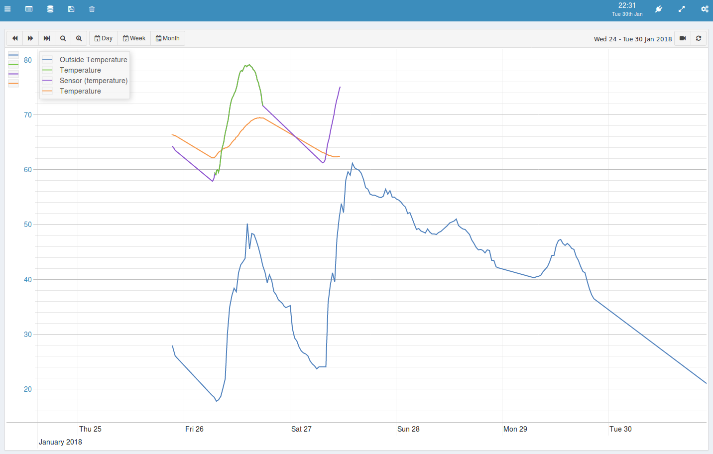

Is anyone here successfully running Influx 1.4? I originally installed 1.2, which seemed ok. Someone had mentioned they used 1.4, so I switched to that. About that time, the zwave events stopped being stored, though LocalWeather values still persisted. Yet those also are now no longer persisting. Any thoughts, including a retreat to 1.2?
