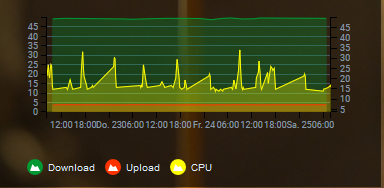

On PC the graphs look good, but on my phone I can barely read the scale:
I did not find how to configure the x- axis (just the y-axis with “ticks”)

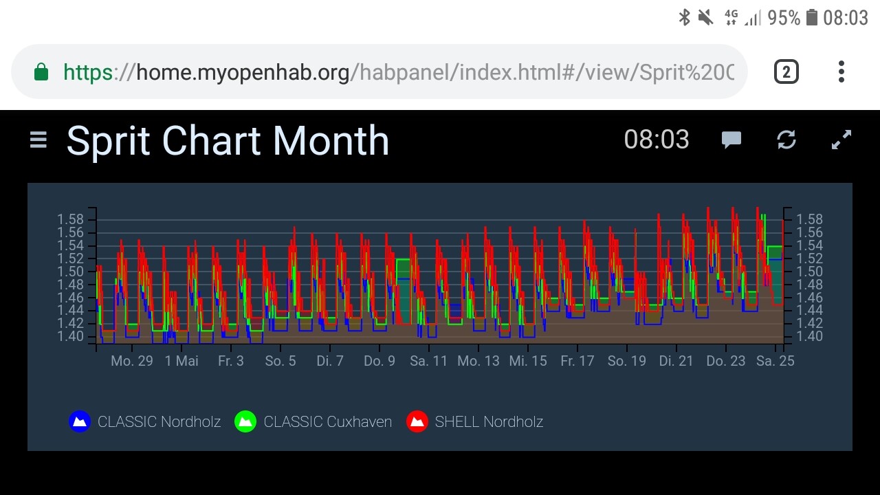

Screenshot was from my phone (forgot to tell).
Moin :slight_smile:
But I assume your’s in landscape mode?!
In landscape mode my x-axis looks good as well, but not in portrait mode.
But that’s a minor thing.
