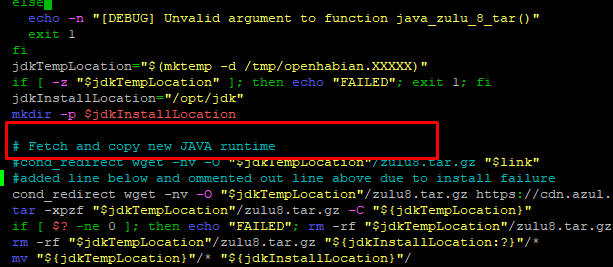

Hello, im trying to follow these steps but when i open the file I can’t see a line:ā€œ# Fetch and copy new JAVA runtimeā€. What should i replace?
This is my file:

I honestly think you refrained from scrolling down. use the down arrow on your keyboard:
It’s there.
