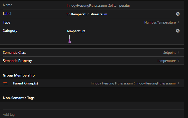

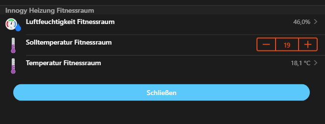

I have an issue with setting the target temperature for my Innogy thermostat. When i change the temperature all looks fine, the log shows the change, but the thermostat doesn’t react.
2021-01-15 21:27:15.410 [INFO ] [openhab.event.ItemCommandEvent ] - Item 'InnogyHeizungFitnessraum_Solltemperatur' received command 19
2021-01-15 21:27:15.417 [INFO ] [penhab.event.ItemStatePredictedEvent] - Item 'InnogyHeizungFitnessraum_Solltemperatur' predicted to become 19
2021-01-15 21:27:15.424 [INFO ] [openhab.event.ItemStateChangedEvent ] - Item 'InnogyHeizungFitnessraum_Solltemperatur' changed from 18.5 °C to 19.0 °C
It is working well on my parallel OH 2.5x installation. I also tested a different thermostat with another Binding (Deconz) and the same item configuration as above in my OH3 installation. This is working well, too. Maybe, this is an issue in the Innogy binding?

Change the type from Number: temperature to just Number. If I remember correctly I had the same issue but with number it’s working.
Oh, so easy :slight_smile: :see_no_evil:
It’s working now, thank you very much!
