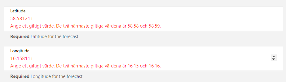

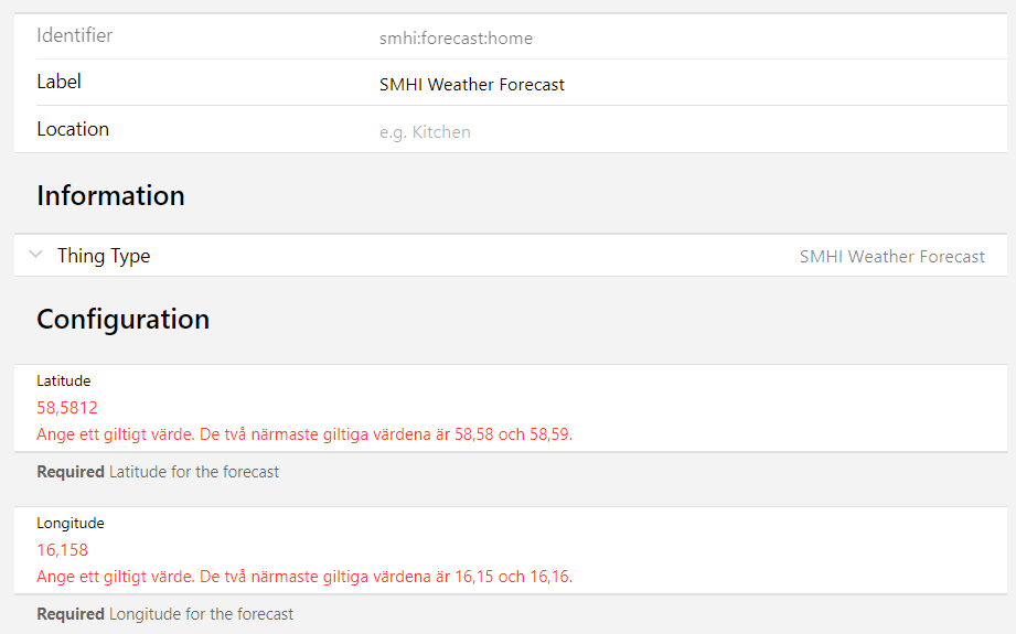

Since these are fields for lat/long-coordinates I need higher precision than this (the weather service supports up to 6 decimal places).
In other places in the forum I’ve read that the UI gets the validation from the binding/thing xml, but I haven’t configured any restrictions to this. But to make sure I tried to set pattern="%.6f" in the config-description, but still the same result. What needs to be in the xml to make this work? Or is it a bug/limitation in the UI? In that case it needs to be fixed before the final release of OH3. @ysc?

(As mentioned I have also tried without the pattern-parameter)
The decimal separator doesn’t seem to matter either, if I use a ‘.’ (with a valid value) and then save, it reverts to ‘,’ the next time I open the page. Guess it uses the browser default locale.
Edit: If I fill out with zeroes they are truncated when I exit the text-box, so had to try with ones.
