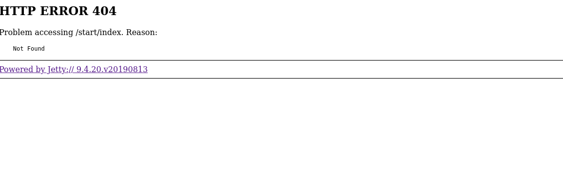

Hello dear community,
I have a problem… After an ubuntu SYSTEM error
I had to upgrade from 18.4 to 20.04,
having previously made a backup of openhab 2.5.x. All applications such as logitechmediaserver etc are running again.
I hadn’t managed to migrate to 3.x yet.
Tried to install openhab 2.5.x. Install worked.
Unfortunately, after the 1st start,
one direction run really long and then error 404 start not found
appears in the html Have tried everything new installation.
zulu11 and javajdk 11.x are installed
What am I doing wrong
Installation tutorial was Download openHAB | openHAB adapted to apt get install openhab2 instead of openhab

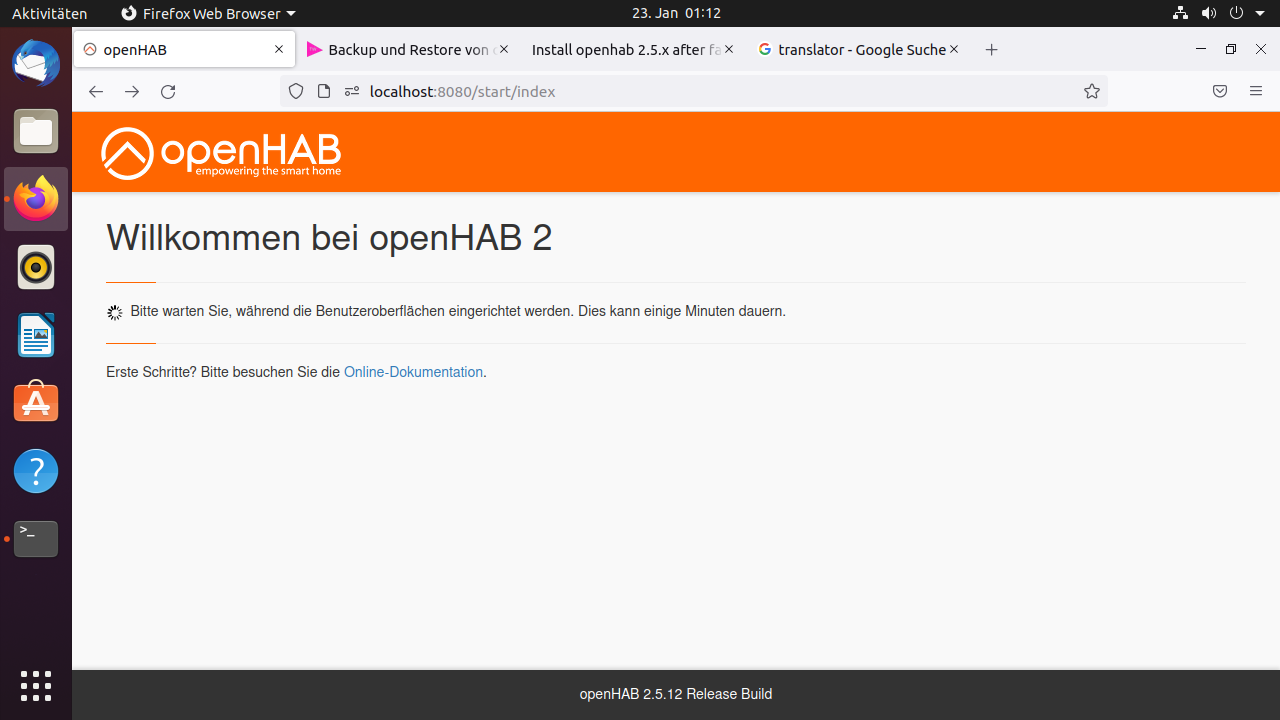

Hi, everyone
it is now running java 8 and openhab 2.5.12
but this message has been on for 3 hours. backup is not restored
I also installed openhab 2 again after deinstallation (apt purge openhab2).
I don’t find the problem

the backup is from 2.5.0 and the openhab install is 2.5.12 …ist that an problem ?
after the restored, this is displayed under localhost
