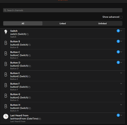

Another observation is I have a KeyPadLink Timer that has 8 buttons but it show up with a configuration of 6. The other 8 bottom Keypad is still waiting for configuration.
