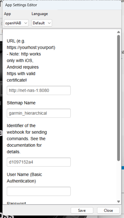

Yes, everything will be configurable. In the app settings, you’ll be able to define the host and sitemap name. In the future, I plan to add support for multiple hosts and sitemaps, with the ability to switch between them through an in-app menu (something I personally need, as I have two openHAB instances at different locations).
The app can now also send commands using my Webhook solution. This requires the Webhook binding, a custom Thing configuration, and a JavaScript script — not exactly a clean setup. Having it work out of the box would definitely be better. Still, building it this way helped me figure out the necessary functionality, and now it will be easy to switch to the REST API (or even support both methods).

And here’s the current configuration screen (shown in the simulator):

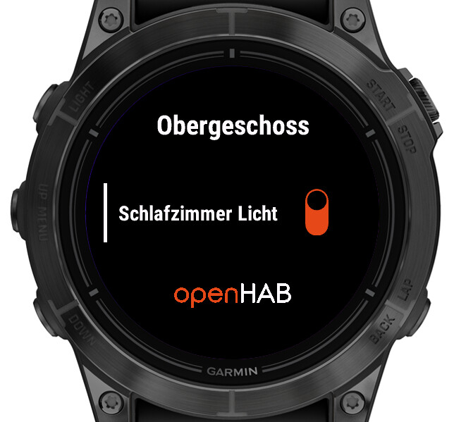

Speaking of which - the screenshot below shows today’s progress.
There’s more going on than it might seem at first glance. Previously, the app used standard UI elements (like the green toggle switch), but these are quite limited and couldn’t easily be combined with custom components.
I’ve now switched to custom UI elements, which not only allows for a custom-designed toggle switch, but also makes it possible to add icons, additional controls, and support for more complex items like roller shutters.
