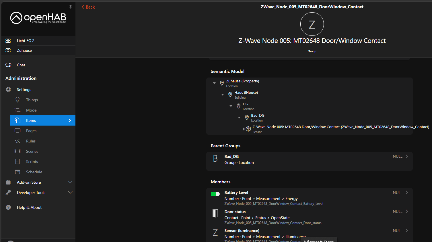

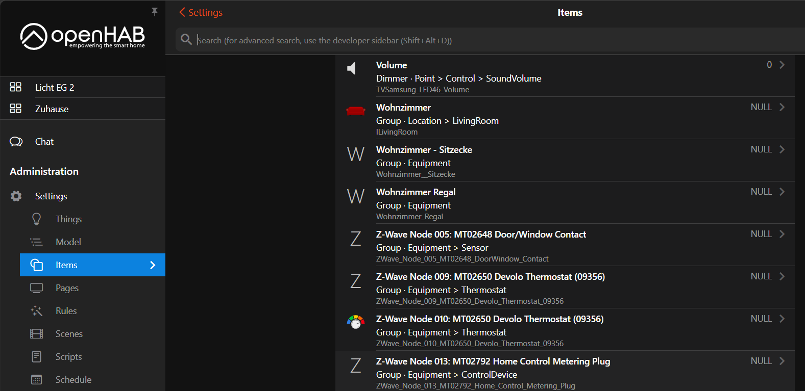

At least the device is visible under items.
Is there something else / something special I have to to? :thinking:

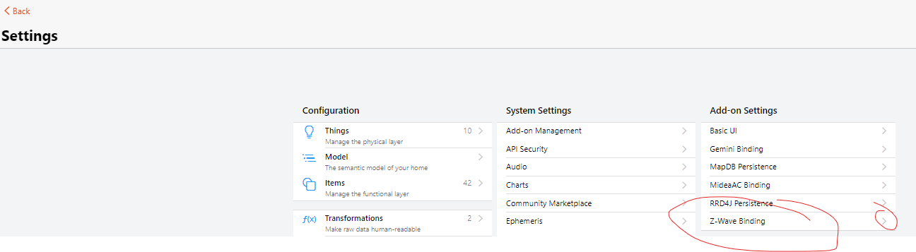

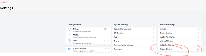

Probably a stupid question, sorry. How do I set the ZW binding into debug mode? :thinking:

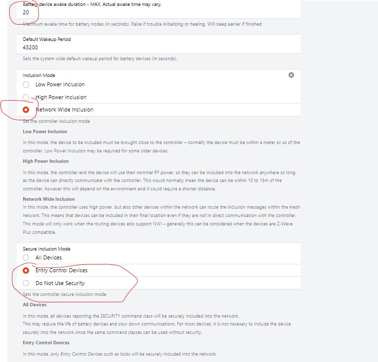

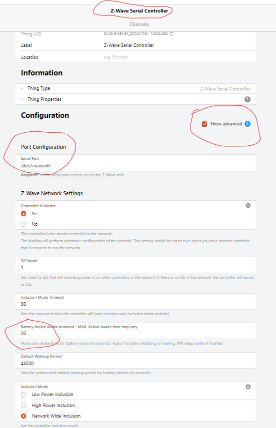

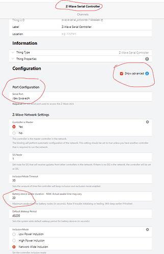

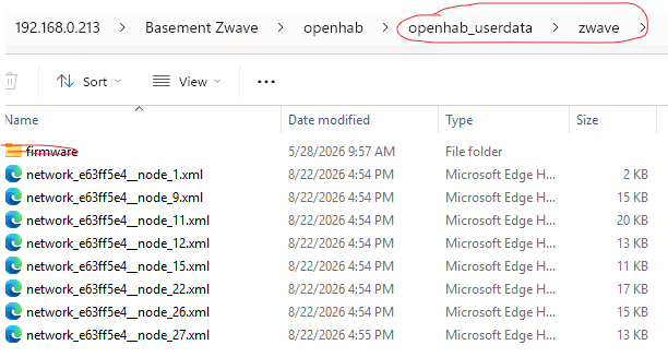

I was hoping to discover several things. In the openhab-userdata/zwave folder are there xmls for the nodes in question?

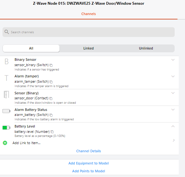

Also I would like to see the channel tab with links (there are none linked in this picture) for one thing
<<I was hoping to discover several things. In the openhab-userdata/zwave folder are there xmls for the nodes in question?>>
There is a correponding xml file. I’m not allowed to attach the file here, so I paste the content below.

I asked again CoPIlot. The summary was:
The MT2648 sends only security‑handshake frames and fails during the process. It provides no sensor data whatsoever. The device is firmware‑locked and no longer usable.
… and again the recommendation to throw the sensor away :-/.
I only glanced at the debug. You need use/click the </> icon before pasting, so it is readable.
However, I see the security issue. The device was included with security (not really necessary IMO), but the key must have been changed. Key is on the controller Thing page (advanced).
Should be no need to throw them away. First, I would try to exclude them (it’s cleaner). The exclude option is on the controller. Worst case do a factory reset.
Check to make sure there are no XMLs with the node. Then reinclude without security, but set the time to 20 seconds.
Lastly look for the presence of the XML. No need for the details. If it is there inclusion was successful
You should be fine

I didn’t find the advanced options you mentioned, sorry once again. I open the Thing part and scan for z-wave. When found I add it with editing. But even if I check the advanced settings box, I don’t find the security options.
However, at least now the battery, luminescence, and temperature are transmitted. Only the door status is still Null. But I must admit I’m not sure if the vaues are correct because they don’t change when covering the sensor. But perhaps it’s just a question of time.
It looks like progress. I can tell you are new to OH :wink:.
My suggestion to check the XMLs after exclusion is a quick way to see if it worked. If that worked, you didn’t need to do the reset. The exclusion/inclusion seems to have worked if you are getting readings. Again, checking the XMLs (and the time stamp) is a way to see if inclusion is fully complete.
As to the device operation, the tamper switch normally has no effect on Open/Close. Put the top on the base. Make sure you are in normal operation (manual is confusing to me). As the magnet gets near the base, the light will flash once (EDIT: reread manual, light will only flash if battery is low, so no physical indication of change) (first time from Null to Close, but after that from Open to Close), then when moved away from Close to Open. A debug log is needed (while doing that) to make sure that is working.
The advanced options are on the Controller Thing
