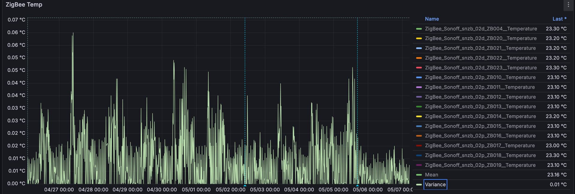

Some charts :wink:
I excluded some the chart the times where I moved things around or introduced new sensors.
While those charts look cool, they don’t speak all alone and when inspecting them, I had the context in mind (ie when I opened windows, etc…). The variance “explodes” no matter what when the temperature changes rapidly due to a window for instance. One of the reason is that the sensors were positioned next to each others and those closer to the WIndow hit the cold sooner. Moreover, those sensors report measurements when “they feel” like it and some rapid change may be transmitted sooner or later depending on the sensors.

I did 2 rounds of adjustments based on on the Variance:
Making those adjustments is ont simple and the fact that I have a fair amount of sensors did help.
I doubt this is reliably possible using 3 sensors…
Out of the 15 sensors tested, here are the offsets.:
