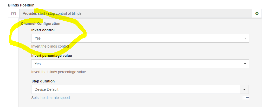

since I am about to switch to manual thing config (at least I want to)… there might be still the possibility like in 1.8 … in the thing syntax?
example for roller shutter
The DB contains whatever the manufacturer of the device says it can do. So if the manufacturer put an invert property in the device, it will appear in PaperUI. If they did not then adding it to the database won’t do anything.
What you are looking at here are configuration parameters for the channel. It is not related to a device, but it handled in the binding. This is for a multilevel switch, but such parameters are not available for just any channel type, and are not available for alarms.
