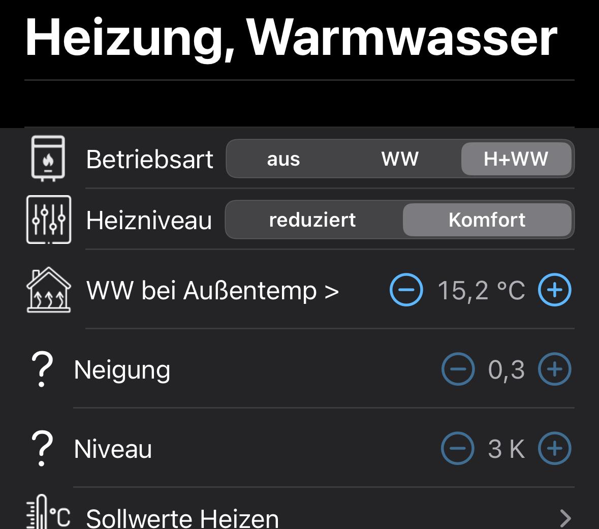

some disadvantages I found in the latest version (and also in the previous version) are:
  • mapped switch buttons are enlarged to fill the entire line (e.g. aus / WW / H+WW)
  • some setpoint items can’t be changed any longer (e.g. “Neigung”, + - buttons are thinner and have no function). In earlier versions this worked.

Good question. I assume, this doesn’t matter.
The temperature in the line above is also displayed with a comma; here as well the value in OH is 15.2 (with a dot). This setpoint works. (You can see the difference in the brighter + and - icons)
I assume this limiting temperature is directly set up in openHAB and is not coming from any Thing Channel.
Exactly.

Yes, in Basic UI or Web Browser it still works fine.
For the meantime, I created a work-around with additional items and a rule (also to avoid error by the comma, which wasn’t a problem so far):
