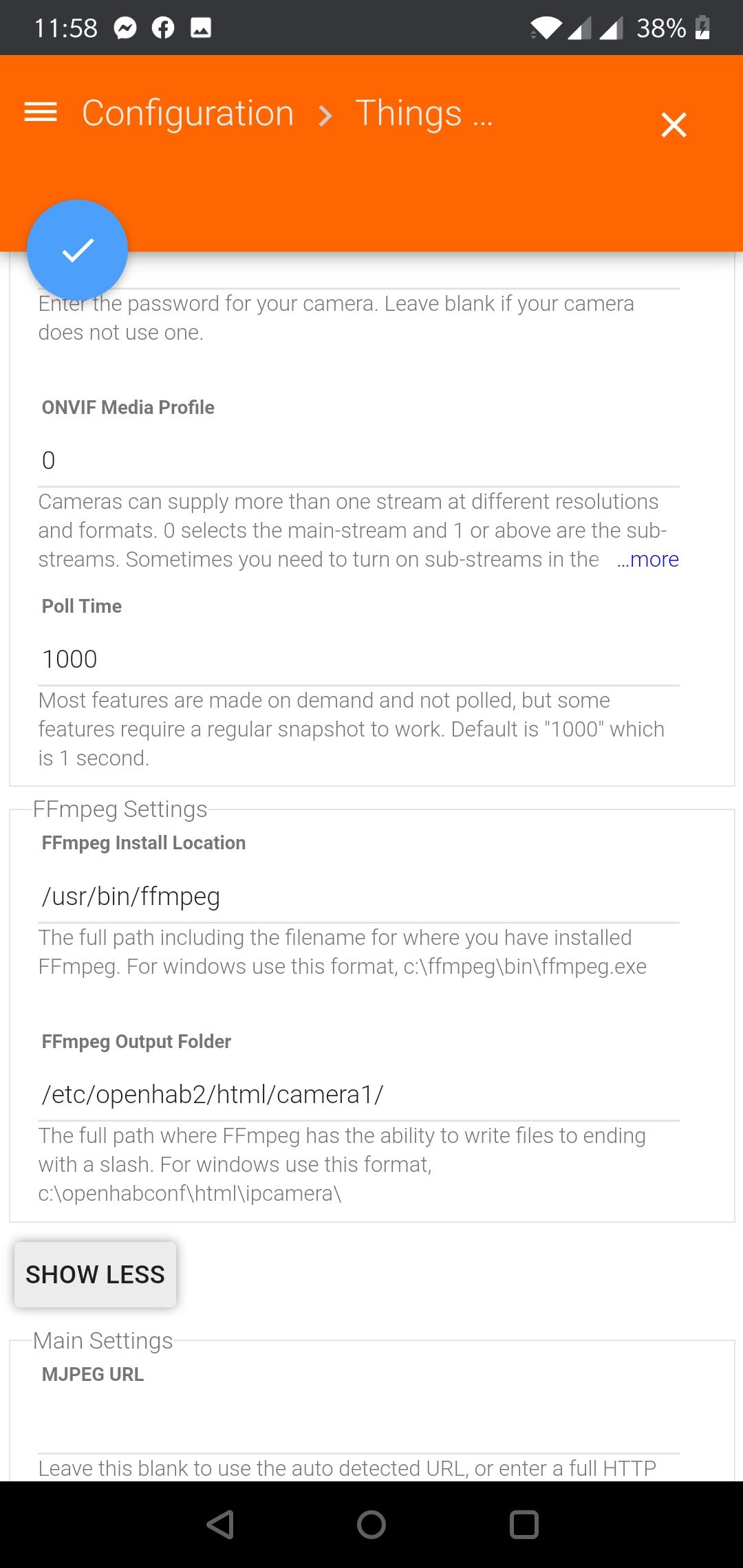

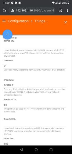

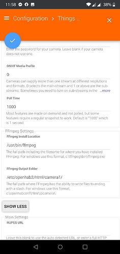

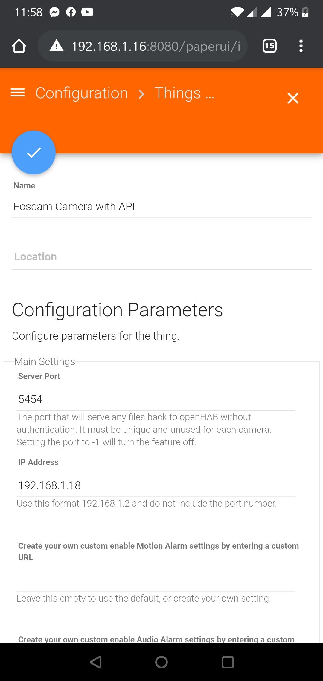

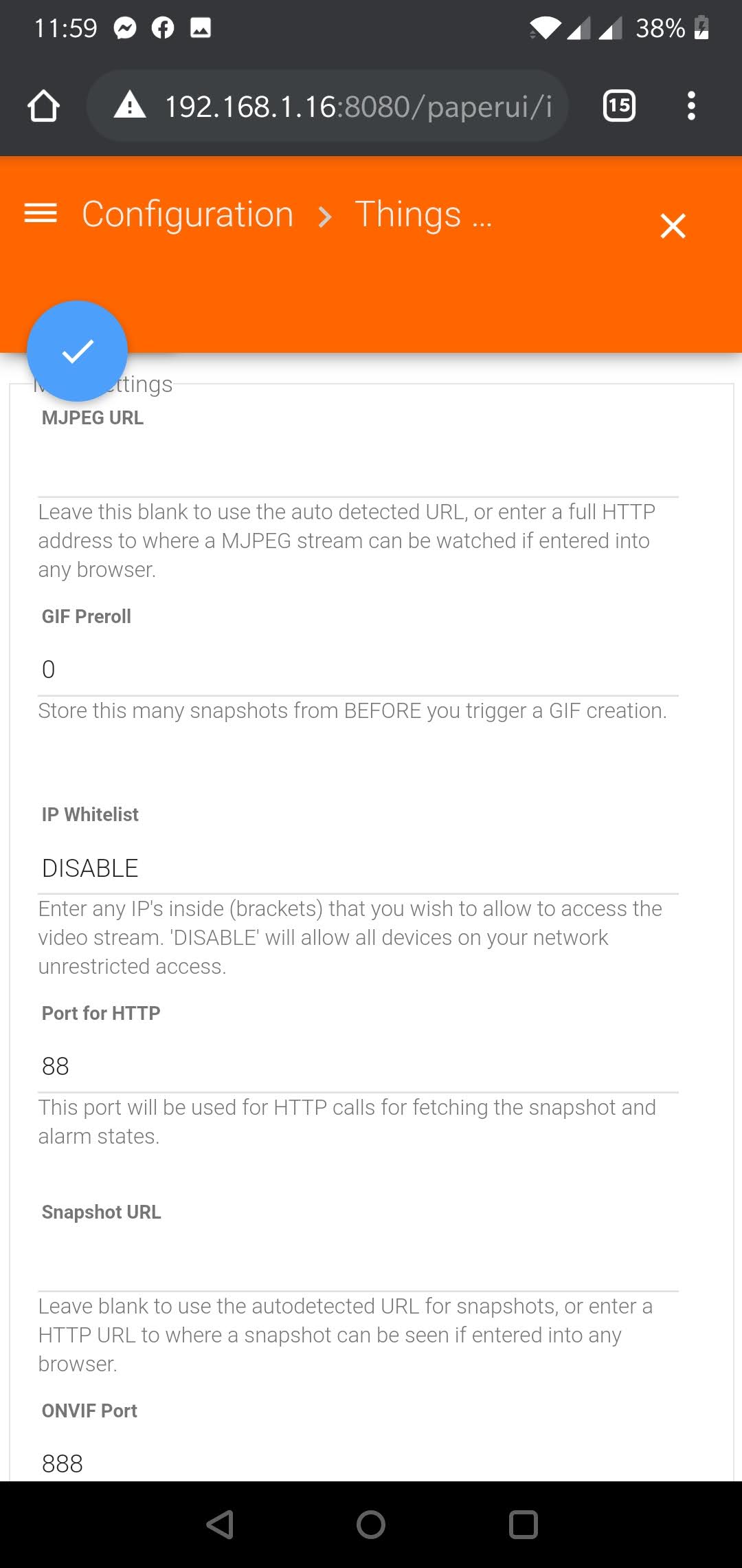

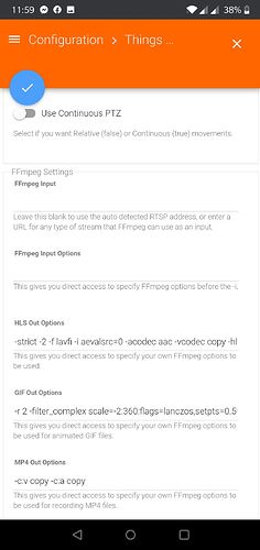

Can u post a screen shot of what settings you put into paperUI?
Screen shots as requested
Your using the ip of the camera when it needs to be the ip of openhab.
corrected and now using the OH IP.
