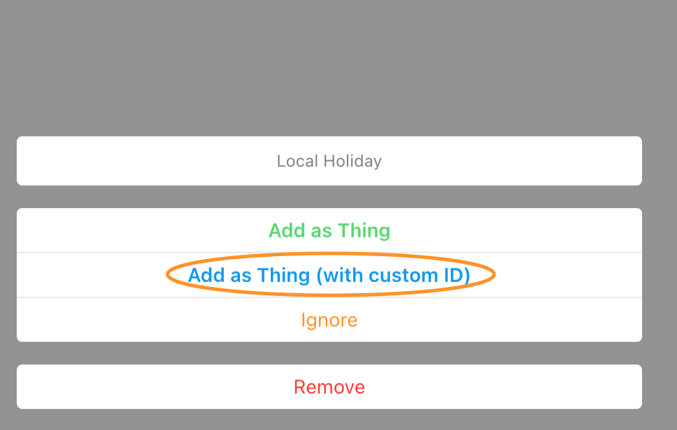

I decided to test variant 2… so I selected “add device manually” because adding from the discovered list didnt give me the chance to set the UID.
When added with the old ID (after selecting the bridge, the constructed, final ID was exactly the same as for the deleted old one) and setting the NEW Device ID (which I find in the discovered things list) the new thing had the OLD device ID (as if internally the old Device was still anywhere in oh’s memory and was retrieved…
Can you imagine why this is so? I can’t set up the new thing with the old UID and new Device ID…
