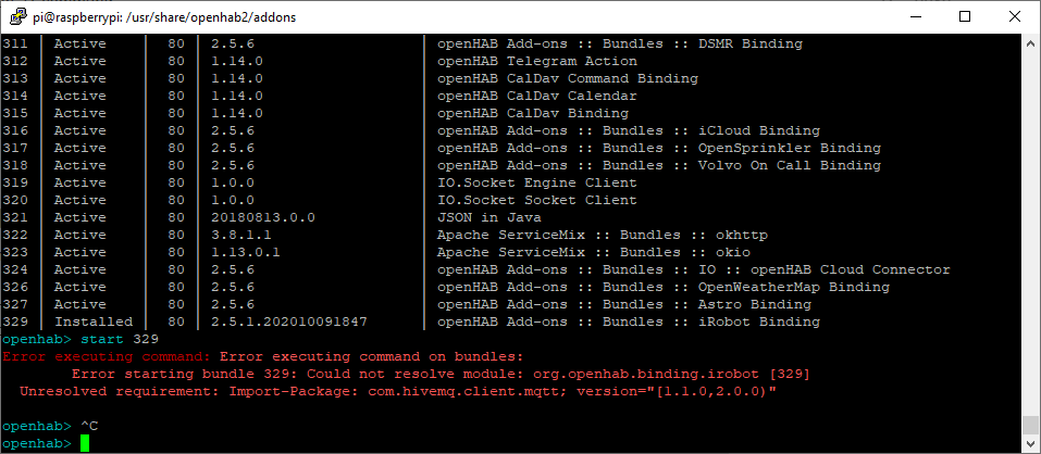

I just figured out, at least for OH3, you have to install the mqtt binding, else you will see an error:
Unresolved requirement: Import-Package: com.hivemq.client.mqtt; ...

Someone is getting this same error when try to start irobot binding?
You have to install the mqtt binding first and then the problem will be solved.
Can I do that manually since my binding tabs are missing in the paperUI?
and the “simple mode” is turned off.
openhab
You can add the binding into the addons.cfg file:
vi $OPENHAB_CONF/services/addons.cfg
Add the binding name “mqtt” in the binding list, e.g.
binding = knx,hue,km200,netatmo,sonos,icalendar,astro,ntp,samsungtv,unifi,hpprinter,airquality,mqtt
But you can also do it from the console. You will find all information here: Installation of Add-ons | openHAB
