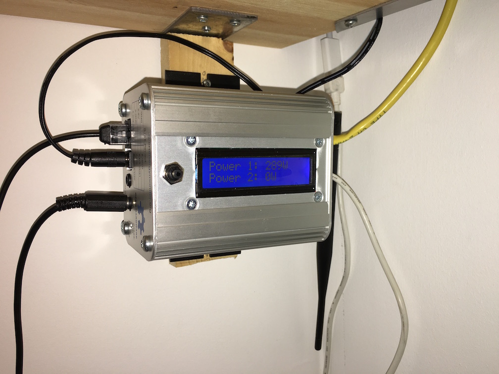

Hi, I’m jumping back on this thread as I have just taken delivery of the final piece of my emonPi puzzle (a new rPi 2) and put everything together. The emonPi case does come with mounting brackets (you can see the top of one of them in the photo).
I’m going to spend some time setting up MQTT to see if I can catch up with you. Will report back if I make any headway beyond what is already mentioned!
Nice!
You’ve jumped ahead of me with the hardware mounting there, I’m going to be mounting mine tomorrow, got some extra brackets I need today.
EDIT: Here’s mine…

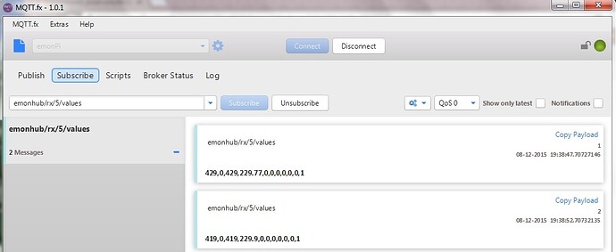

I run MQTT.fx for troubleshooting from a windows machine, subscribing to “#” should get you all the messages on your network once you tell it to connect to the broker on your Pi, putting a checkbox in “Show only latest” should show whats around. Download from this page
On my Pi that’s running the EMONPI image,
entering “mosquitto_sub -t emonhub/rx/9/values” shows the values as they are sent, (you will need to substitute 5 instead of 9)
entering “mosquitto_sub -t #” shows everything albeit with no reference to which topic is being received
NOTE ITS BACKSLASH #, for some unhelpful reason the forum removes the backslash
assuming this gives you something, you can then use a tool on another machine to see whether the messages can be received with one of the mqtt client tools
Yeah I’m getting the emonhub MQTT messages on my iMac. So it’s something on the openhab Pi that’s blocking.
Not that it’s much consolation but I think I’m in the same boat as you. I’m not getting anything on my openhab rPi but when I try a local Windows client things look rosier.
